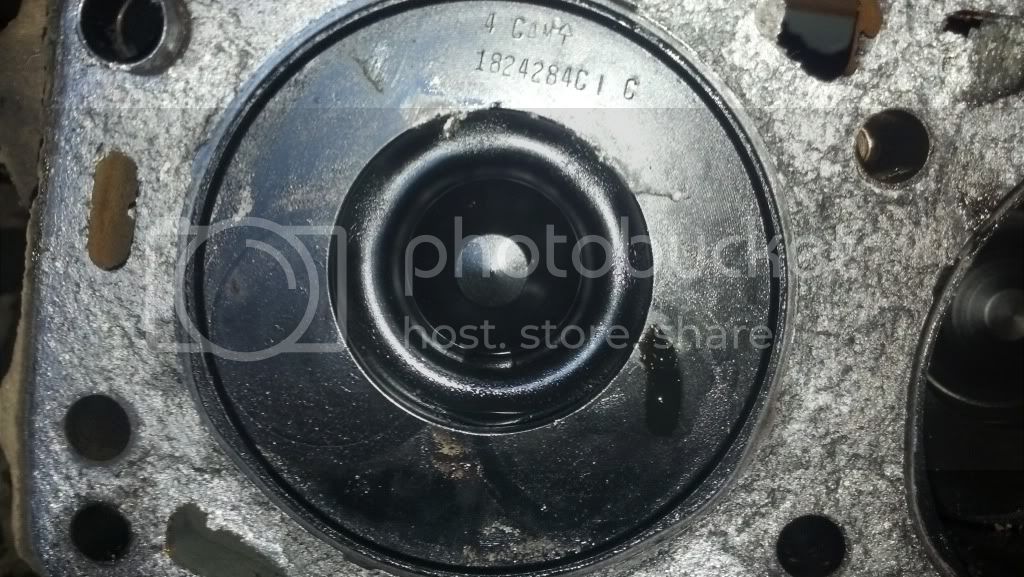

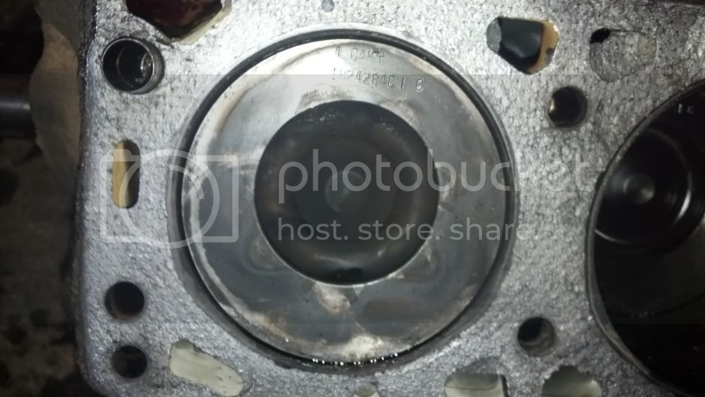

Umm..... Yeah. Definitely some piston to valve contact! Lol!
Tuning looks awful good to me. Star pattern looks like all the stock motors I've pulled apart. I pulled one that had ** ****** infamous piston cracker tune and the star patter went all the way to the cylinder walls. I'm happy with the way things turned out. Its just a shame I didn't blow it up under different circumstances. Lol! I'll have her back on the road in no time!!
