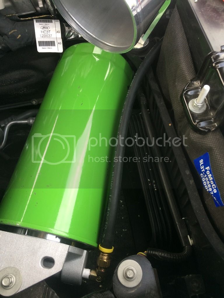

Finally got around to getting the bypass installed on my 17. Jim found a great spot underneath the air intake. The filter is very well protected and easy to access. The Parker push loc hose that Jim sends with the kits is a breeze to work with.
