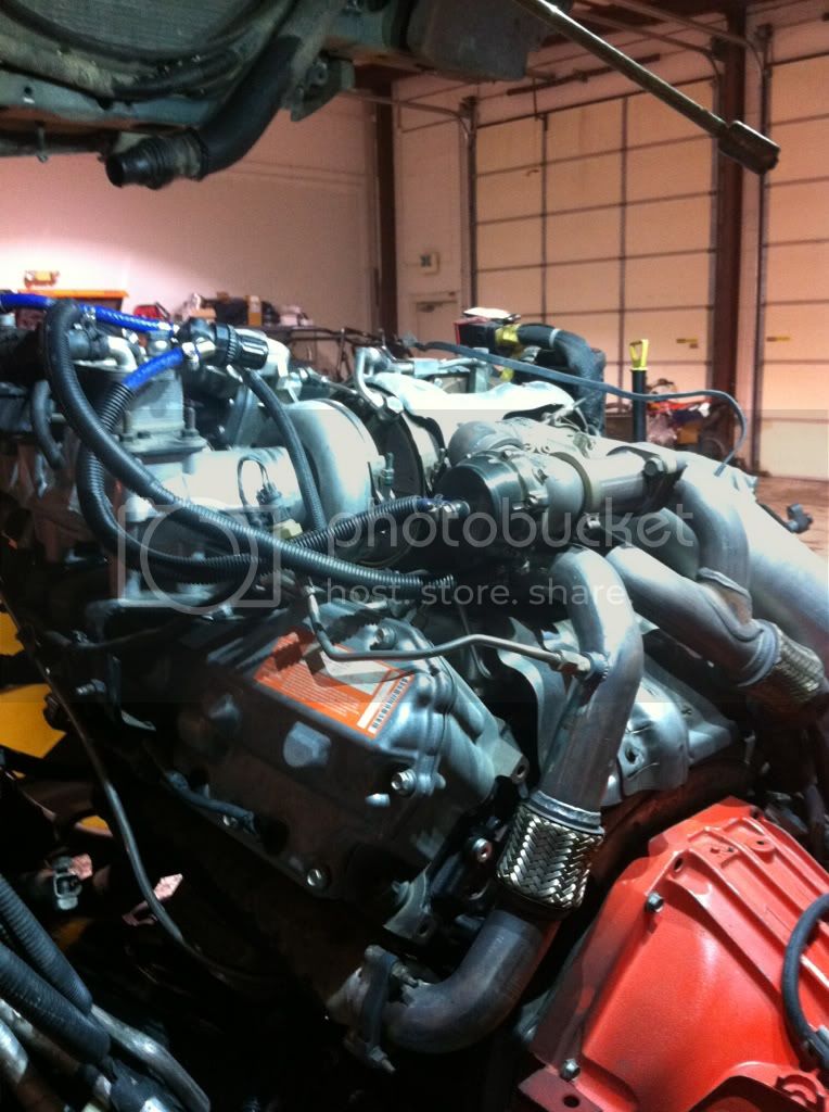

Turbos are off. Just have to give ford a call mañana and get a few things (hopefully they have it).
Wish I had a something good to tow back home to tests these ad mofos out. Staying water cooled due to towing for work.
Here is the last pic I took... Minus the turbos and all that good stuff
