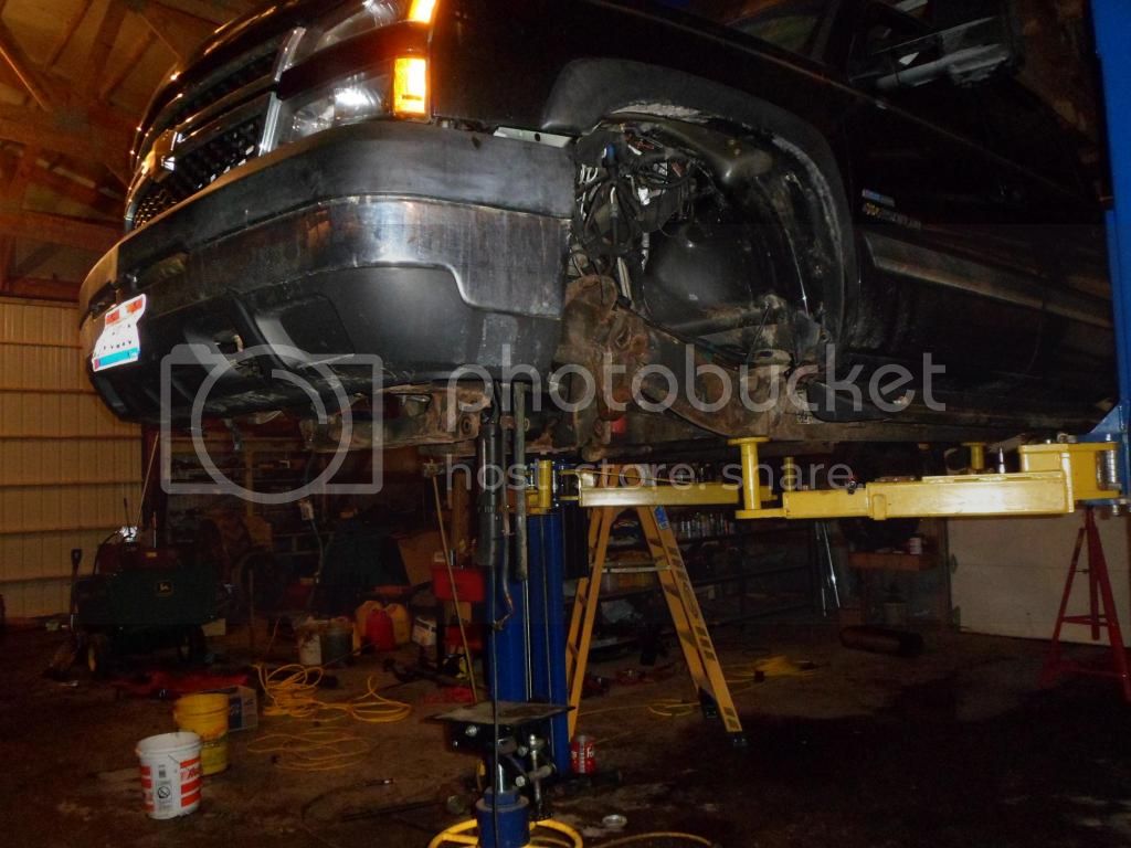

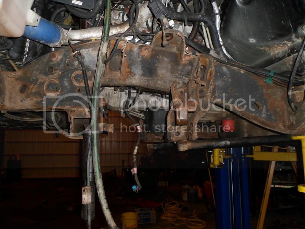

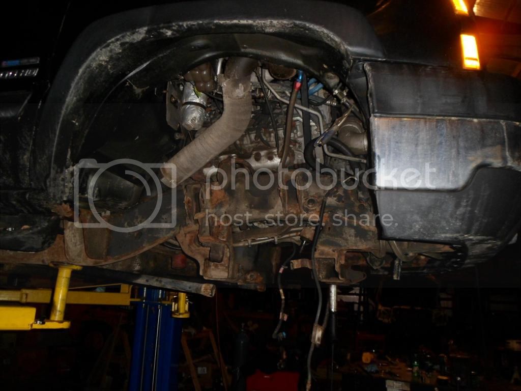

I made a little progress today - had a couple issues that I'll just have to deal with when fitting a bunch of aftermarket stuff together that was never intended to go together. LOL
Pappy boards are gone thanks to Matt_P!
There is no turning back now! I started slicing off brackets with the plasma cutter!
A big thanks to both Matt_P and Bryan (01Dmax) for some assistance today around the shop. Plenty more work to do, but hopefully tomorrow after some clean up work with the grinder I might be able to tack weld in the first couple pieces of new steel!

Are you going to paint the frame also?
You don't think I should leave all that fantastic GM undercoating and rust like it is?
Yes - the whole rig will be getting POR-15 with a semi-gloss top coat. Right now it will just be in the "visable" areas - but I'm already planning on pulling it down the bare frame (no cab, bed, or drivetrain) to get everything else painted because there are a couple of areas that I can't weld and can't finish cutting off brackets and clean up with the engine in the way - plus I need to update the body mounts to they hydraulic version so it can take care of some of the road beaming problem that these trucks have.
Future, but not too distant plans include a fully custom HRT built bed as well....
