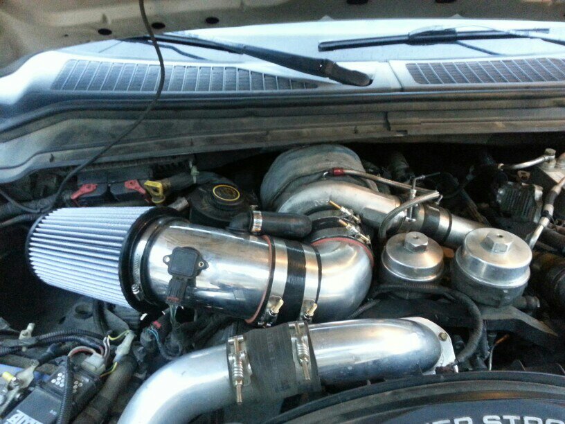

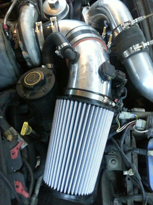

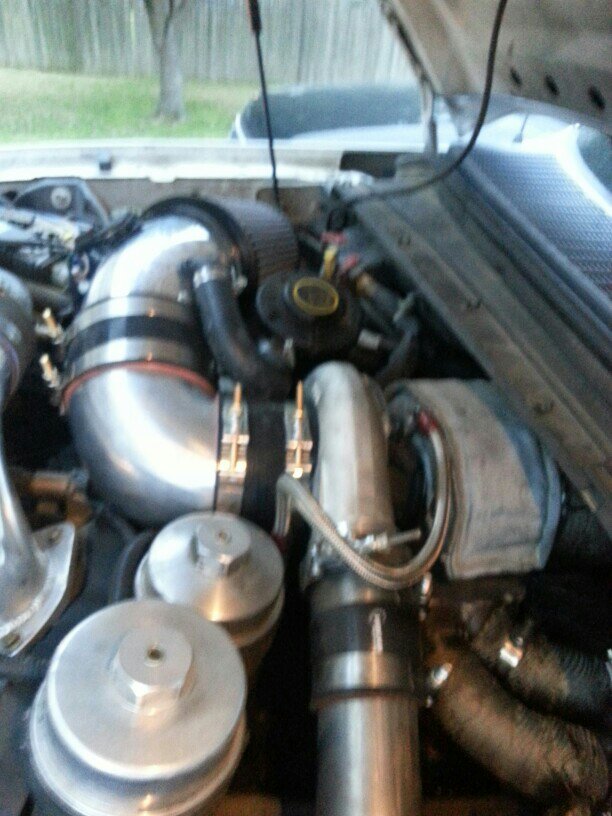

can anyone post a pic under the hood of a single? im curious as to what it looks like under there, what you have to do with the intake, the fuel cooler/ acuator lines, and how you mount the fuel cooler, i dont plan on deleting the fuel bowl for a bit. jw what the set up looks like
Here's some of mine, I still have the factory fuel cooler hooked up though.
