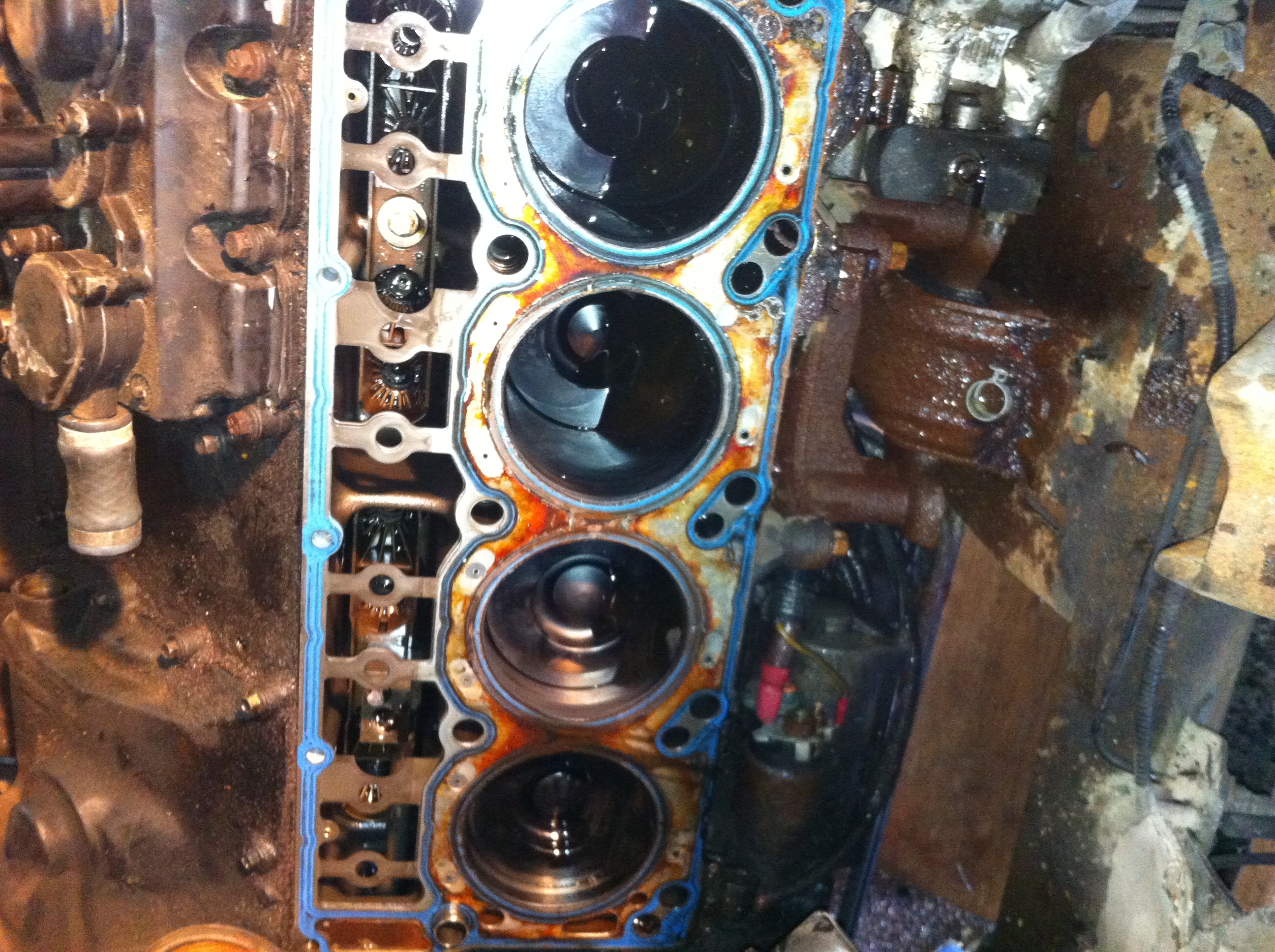

How dose this look. Dose anyone think these head gaskets are good.

Gaskets look okay to me. And this thread belongs here not project forum. That forum is more for custom modifications and one off builds
