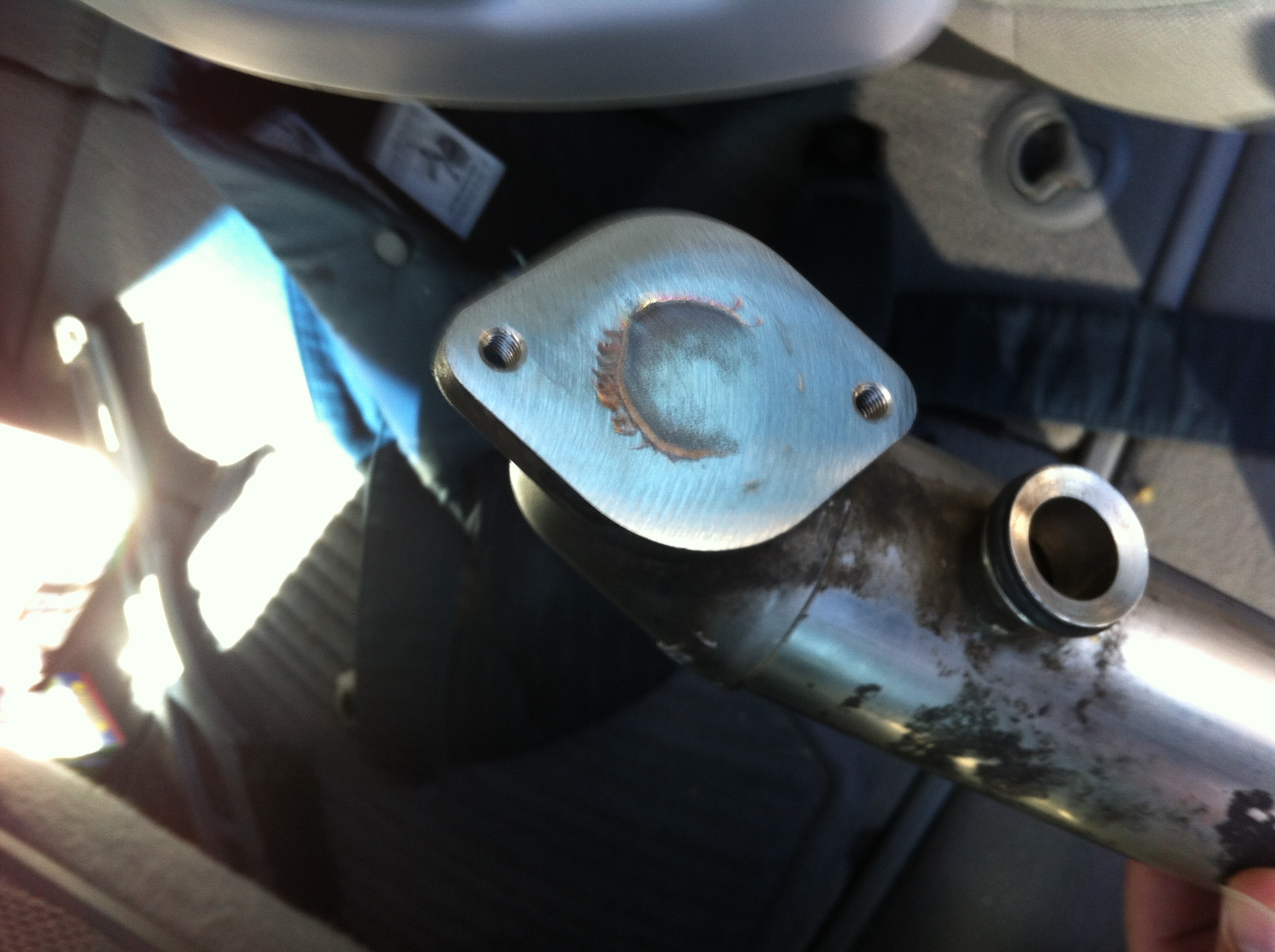

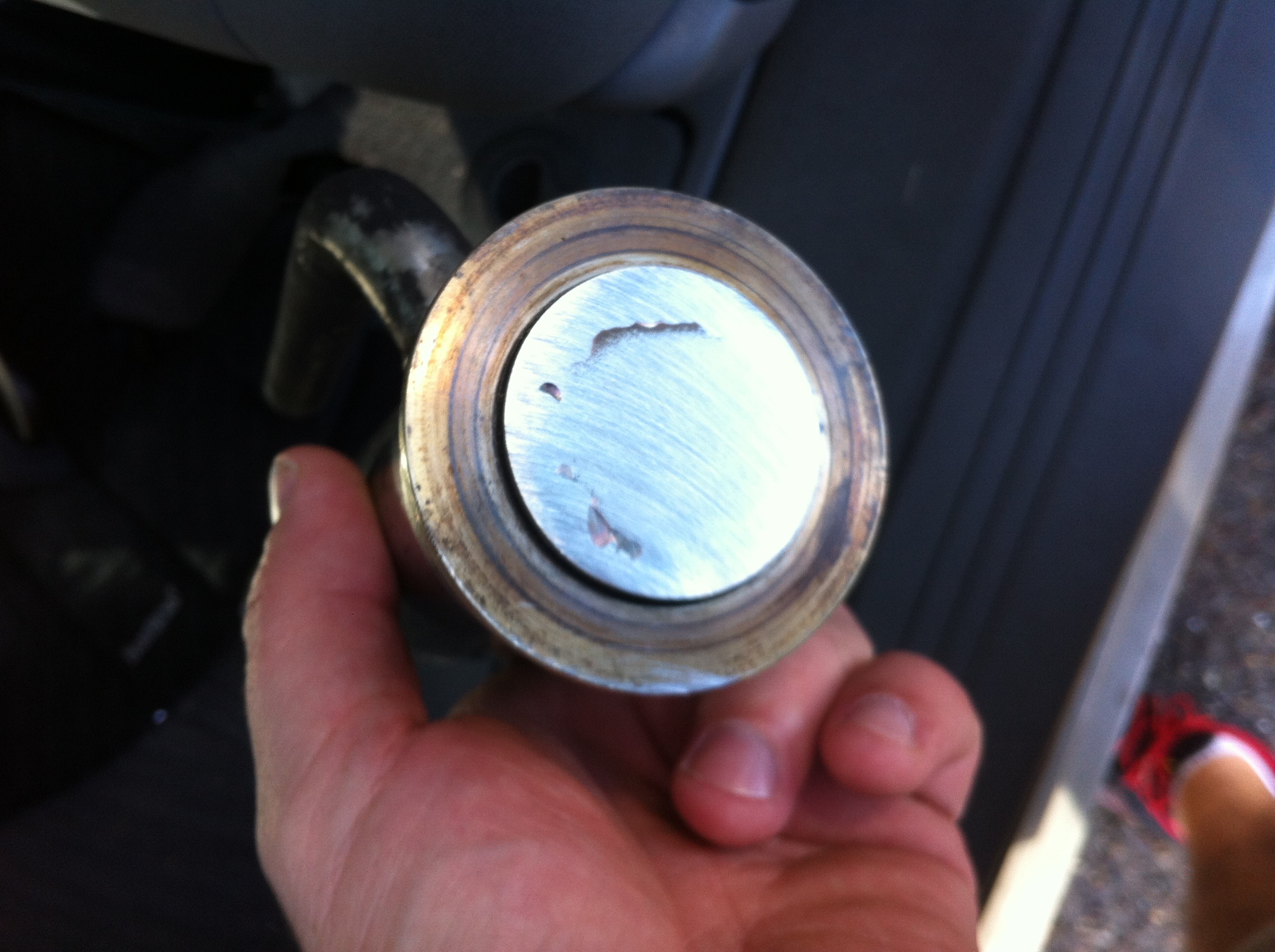

Today I hot my EGR cooler welded. Heck of a lot cheaper than a delete

As long as you have an sct tuner you won't get any egr flow codes. Otherwise you might get a check engine light from those codes
