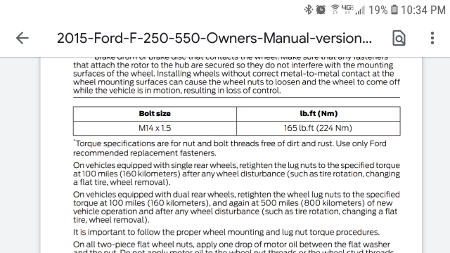

Superduty lugnuts are supposed to be 160ftlbs....

No they’re not. If it’s an OE lug nut, 150ft lbs is stamped right on it.
Supposed to get a drop of oil between the captive washer and nut, then torque.
Hmm.. maybe i thought they said 160 on them. Lol.. either way. My 2000 owners manual said 150 to 165 and my 2015 owners manual says 165 ftlbs.. and correct about the oil. I use fluid film myself.
live life full throttle
My 12 said the same as my 15....
Well......:slap: I’ve done very little wheel and tire work on the 11+.
Regardless, they aren’t supposed to just be run on with an air wrench like too many clowns do! LOL
