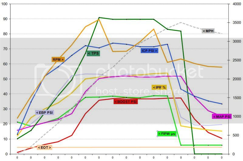

TMCCOY
Jan 31, 2016
109
Utah
Heres another graph showing a more productive run. It was a good roll into third and shifting into 4th hitting nearly 90mph. The ICP is holding ~2900psi while commanding 3.8 pulse width. Boost is 37psi. I thought I was floored but the PID shows 90% throttle...hmmph.
