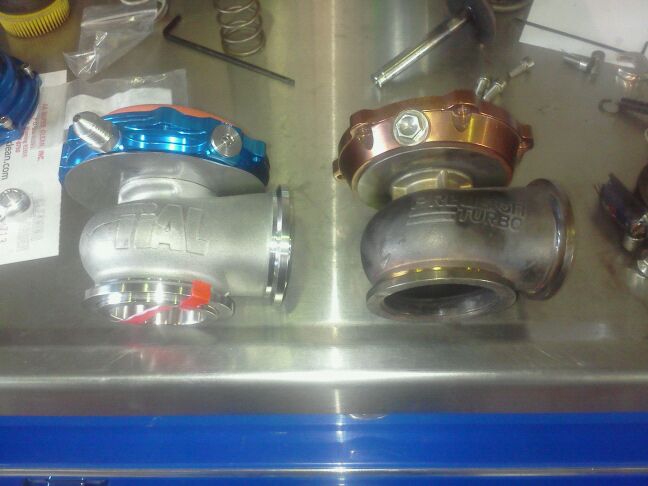

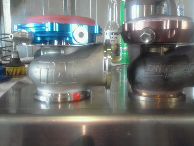

Wastegates side by side.
The Tial has a much larger heat shield.
