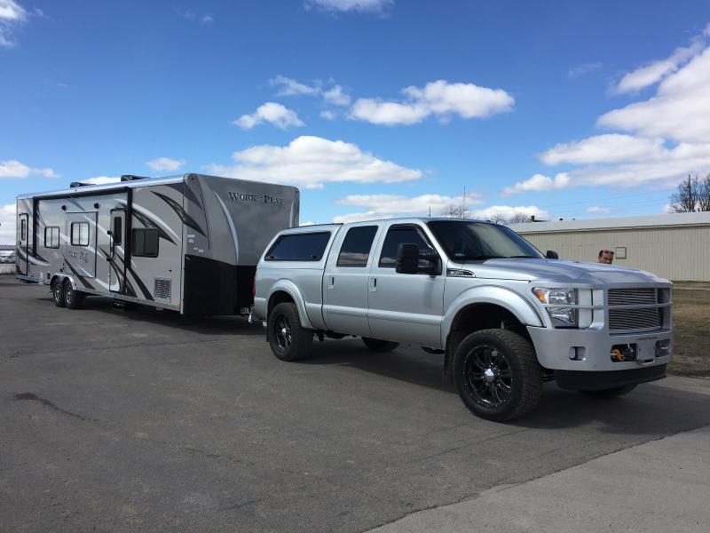

Picked up my new Toyhauler this weekend. Live in SC and picked it up in northern Indiana. Forest River Work and Play 34wrs. It's a 34' box, 41' overall. GVW 16,000. Double 7k axles. G rated tires.
Used the Reese Straightline 1700lb hitch which has built in no-sway.
The trailer is quite the handful in the wind. Yea, I know, it's not a 5th wheel and it's like a giant sail, but still, I'd think I could get it better.
Truck pulls it like a dream. Truck is a deleted and tuned '12 with gearhead tunes. Gets about 9mpg which is about half what it gets empty. Stops just fine. Downhill on the turbo brake it does pretty well too.
But the sway is really a white knuckle experience in wind.
I'm loaded pretty good on the hitch though. 2500lbs which is too much I know. Normally the trailer won't be empty so it'll have toys (bikes & ATVs) in the back to counter balance it and get some tongue weight off. Trailer had 9350 on it's axles. W/ the load leveling hitch we got 900lbs on the front axle and the rest is on the rear end.
Yes, I know it's not a dually and that would make things better, but these nittos do quite well compared to something like a BFG.
A couple things occur to me to help this issue.
1 and probably the biggest factor would be to shorten the receiver hitch. It's gotta be sticking out 1' from hitch to ball. I'm sure I could modify it and slide it in another 8-10" which would reduce the leverage on the truck signifigantly.
2 would be some airbags, though with better balance on the trailer maybe I don't need them.
3 Traction bars. Plant that rear end a little tighter.
Anyway what do y'all think?
