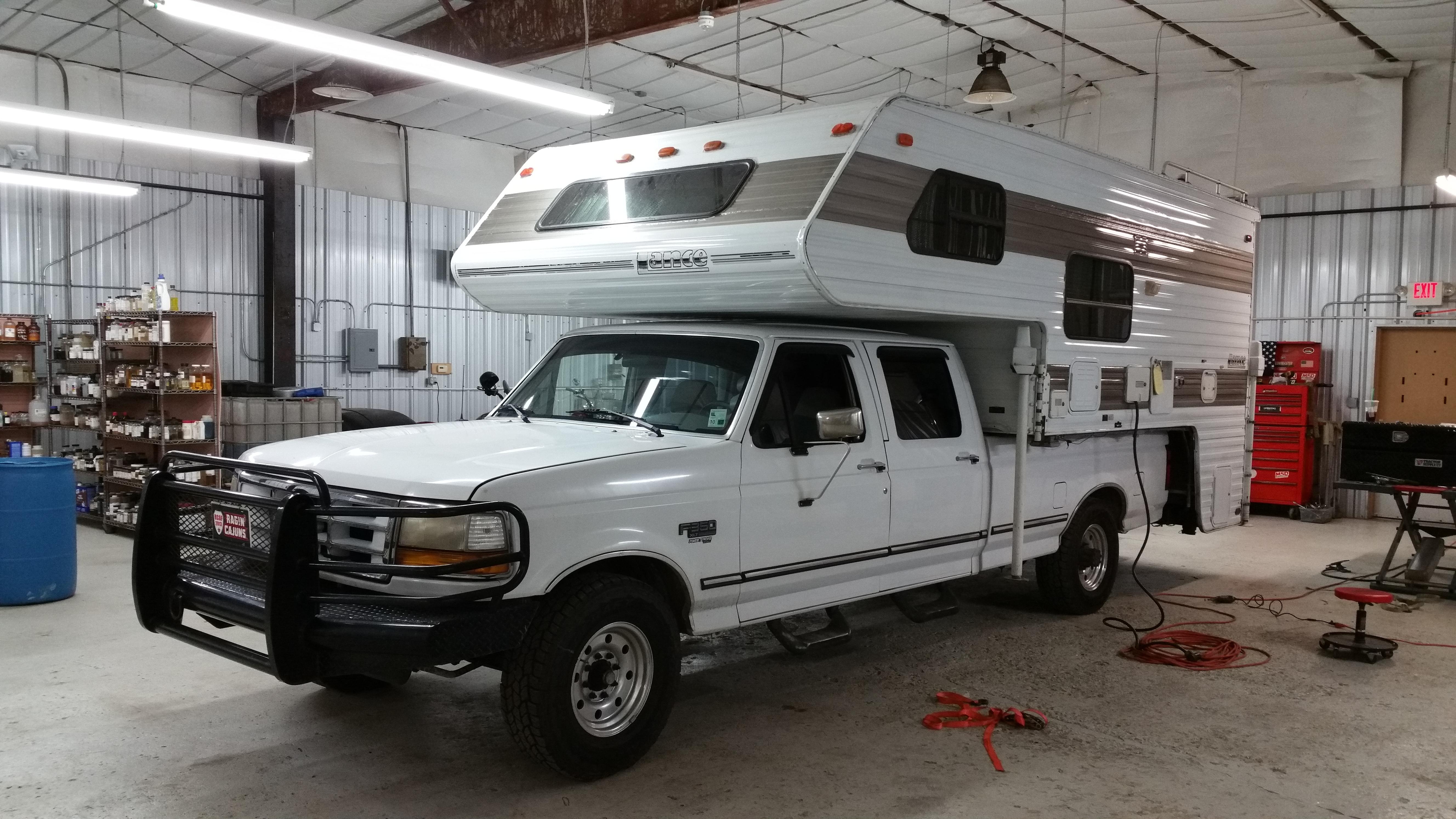

Halestorm55
Aug 12, 2014
220
Skiatook, OK
We have a slide in hitch extender thats like 4' long and added a 3/8 piece of bar stock that goes into the ball mount in the bumper for extra support. I'll take a picture when I get home if I can remember. I have no idea what brand it is though.

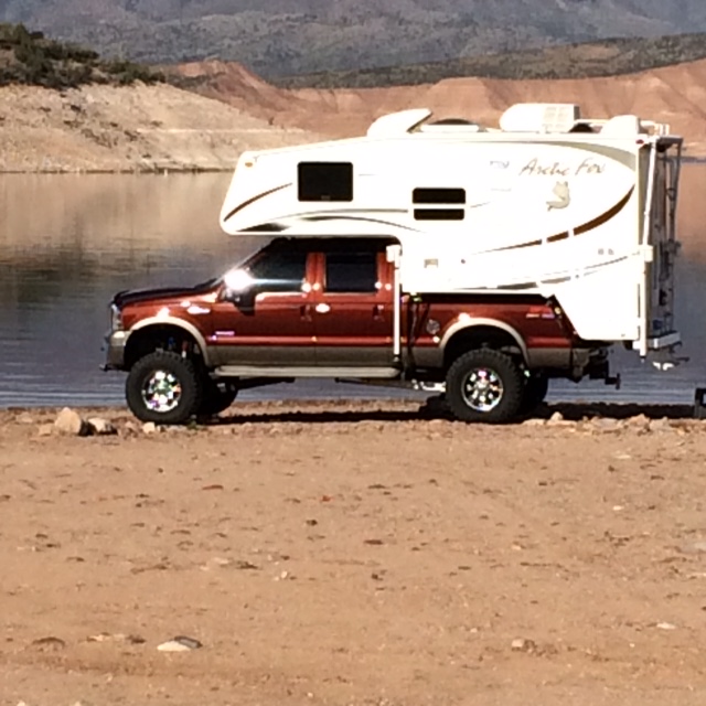

Zmann
Aug 5, 2011
4,464
AZ
2006.1f250
230
DFW
I built my own also it has 4 hitch points and a 40"double beam extension
picture is a single bar test fit before the modification
I also built my own tie down anchors for my camper
removable like a torklift but strong enough to lift the truck from
when in doubt bust the welder out ;-)
but the Superhitch Magnum is what I would have done if money was no issue and I was towing heavy
http://www.torklift.com/index.php/products/towing/superhitch-receiver-hitches/superhitch-magnum-30k
Nice Fox! I have a 990.
Halestorm55
Aug 12, 2014
220
Skiatook, OK
Sorry I took so long finally found the dang thing.
Looks like a production model
Bottom bar to truck is solid 2"
96 model lance camper hangs over about 4'
1/2" flat stock mounts to bumper in forward hole
Works really well and could easily be made.
