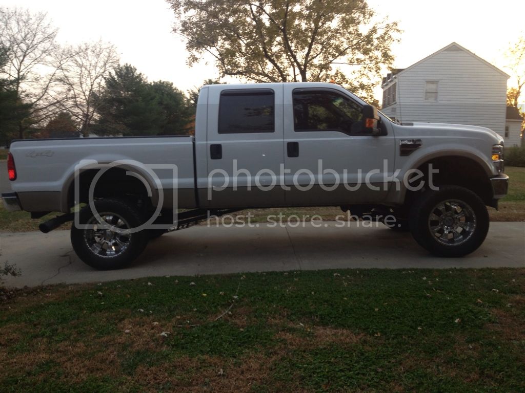

I'm running one up off road products front to back no squeaking,rattling etc etc.use to feel a vibration from take off before I got them and its gone now. I got them from Jared at rcd love them. He spec'd me out what I wanted for my truck perfectly with little information I knew about the lift on the truck.
Not the greatest pic but you can see the traction bars and ala's
