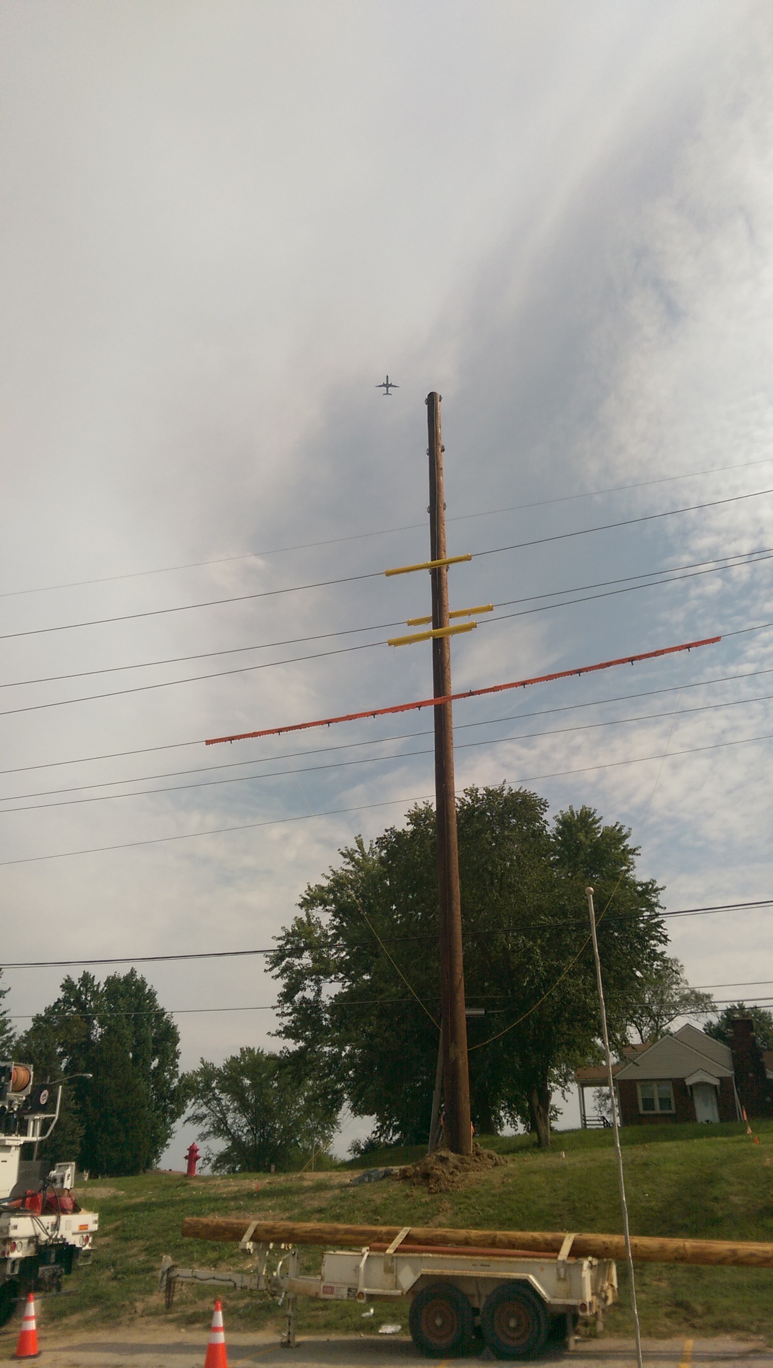

I forgot, you high liners are a different breed..
