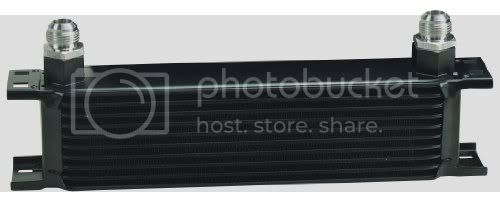

im pretty sure you can make your own or buy a kit and slightly modify it. we dont have that many place to locate trans coolers but i would think a narrow cooler behind the front bumper would be a good idea if you plan on not running a fan. similar to this...
if you do run a fan then you can hook it up to an auxilary switch or some king of switch to make the fan come on at certain temps. derale makes something nice, i know a member from the other site did it bet i dont think he gave any feed back.

I was looking at the Derale one and one from Hayden. I think the one form Hayden is a little more compact, and it has a fan - similar to the Derale in the pic you posted. I am thinking about just using a rocker switch so I can turn it on when I'm towing, and just normal airflow for DD.
