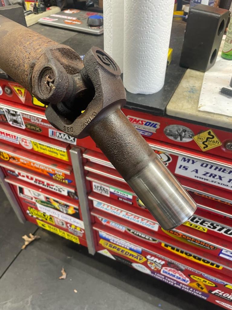

When I put my 4 inch lift kit on the truck, the rear driveshaft slip joint, where it goes into the transfer case was approximately 1/2" out from where it was originally. I did not think that 1/2" out would hurt anything since it was still on the output shaft about 2 1/4 inches....
But the other day I noticed the seal was leaking, and now there is some slop in the slip yoke where it goes onto the shaft .....
If I push it in the extra half inch, or even more, the slop almost goes away
From as far as I can see the splines on the shaft look fine, and the splines on the inside of the yolk look fine
What are the chances of the yoke splines being bad or worn?

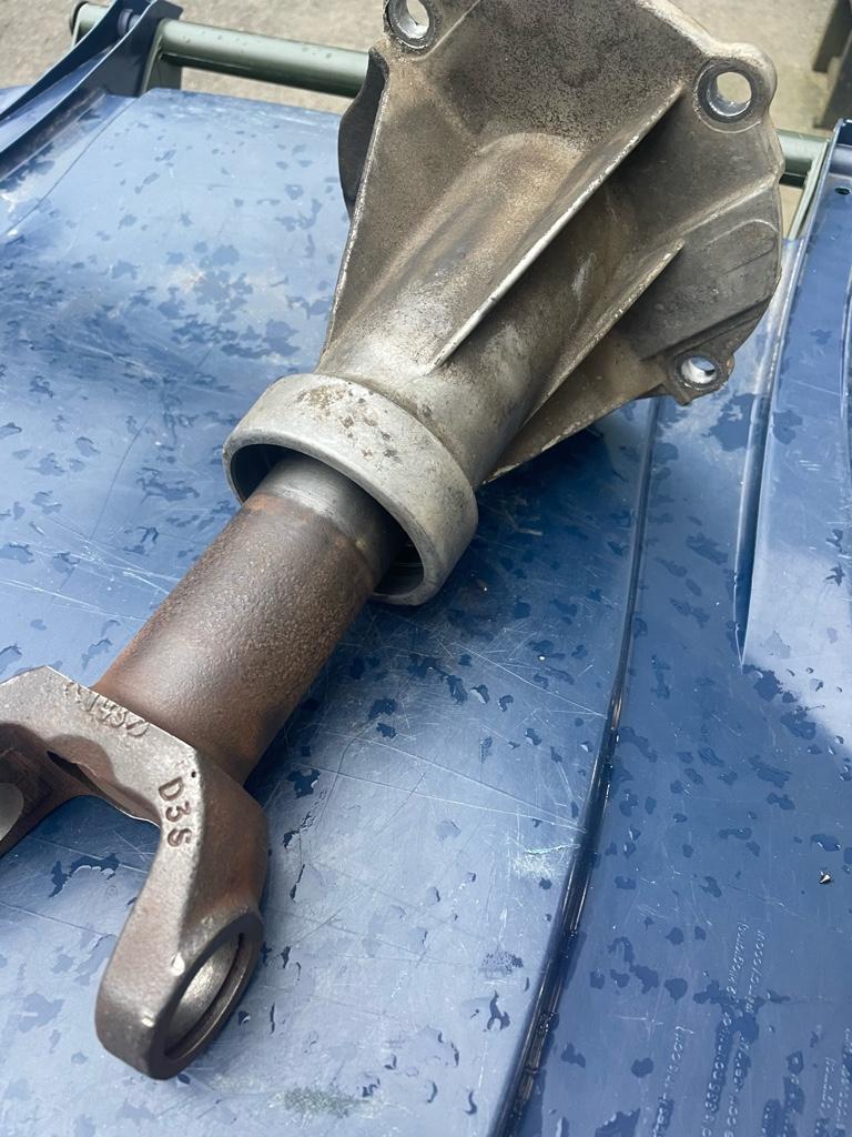

Anyway, this bushing is obviously worn. You can just about see daylight looking through it when the yoke is in there.
That black rubber spacer was way in the back I assume it's a buffer in case you push the yoke in too far.

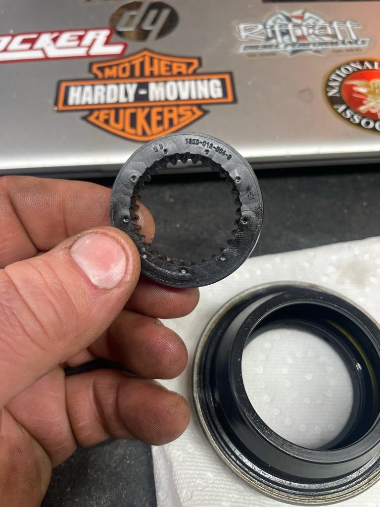

That rubber piece, I think is an oil slinger. Keeps the yoke from filling with oil and leaking out.

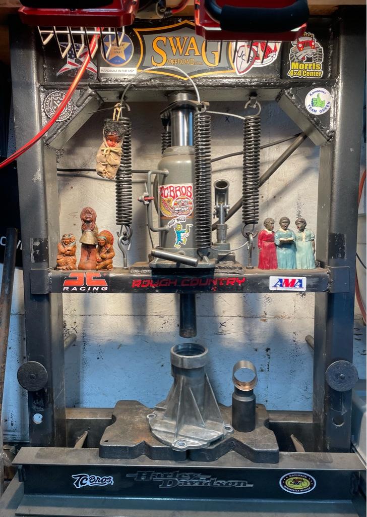

Camerota truck parts got me a new bushing (bought 2)
Hopefully be in tomorrow
Nice to have a press
