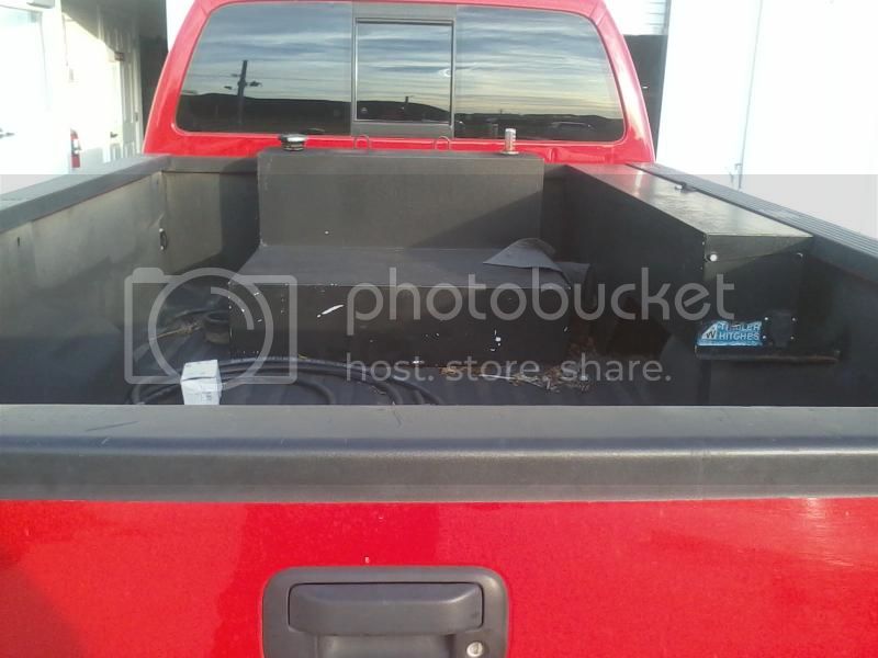

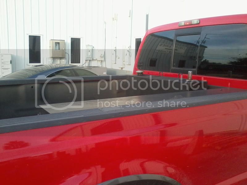

This is my setup. I picked up this 55gal unit as well as a 100gal unit at an auction for $175. I have it t'd into the vent line from my main tank after it goes through a 15mic water sep/filter. I have it controlled by a solenoid valve.
