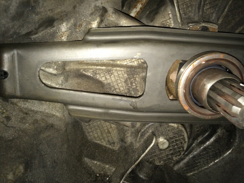

Well for any who care or decide to go this route with a valair triple disk clutch, the issue was the left side throw out fork was grinding on the finger adj.. so we adj the fingers and marked on the arm where it was hitting, cut it out, recessed it about 1/4" and welded it up.. worked fine now, no rubbing issues.. haven't pulled with it yet so can't say about longevity yet..

Nice! Pictures would have been great! Next time you pull it down, make sure to do this.

Here's some pics my buddy took, notice the scuff marks on the orginal arm. Then you can see where we cut and we're able to recesse a small piece for. Clearances.. still almost 1/2" behind it inside bell housing so no worries there.. hope this may help someone..
