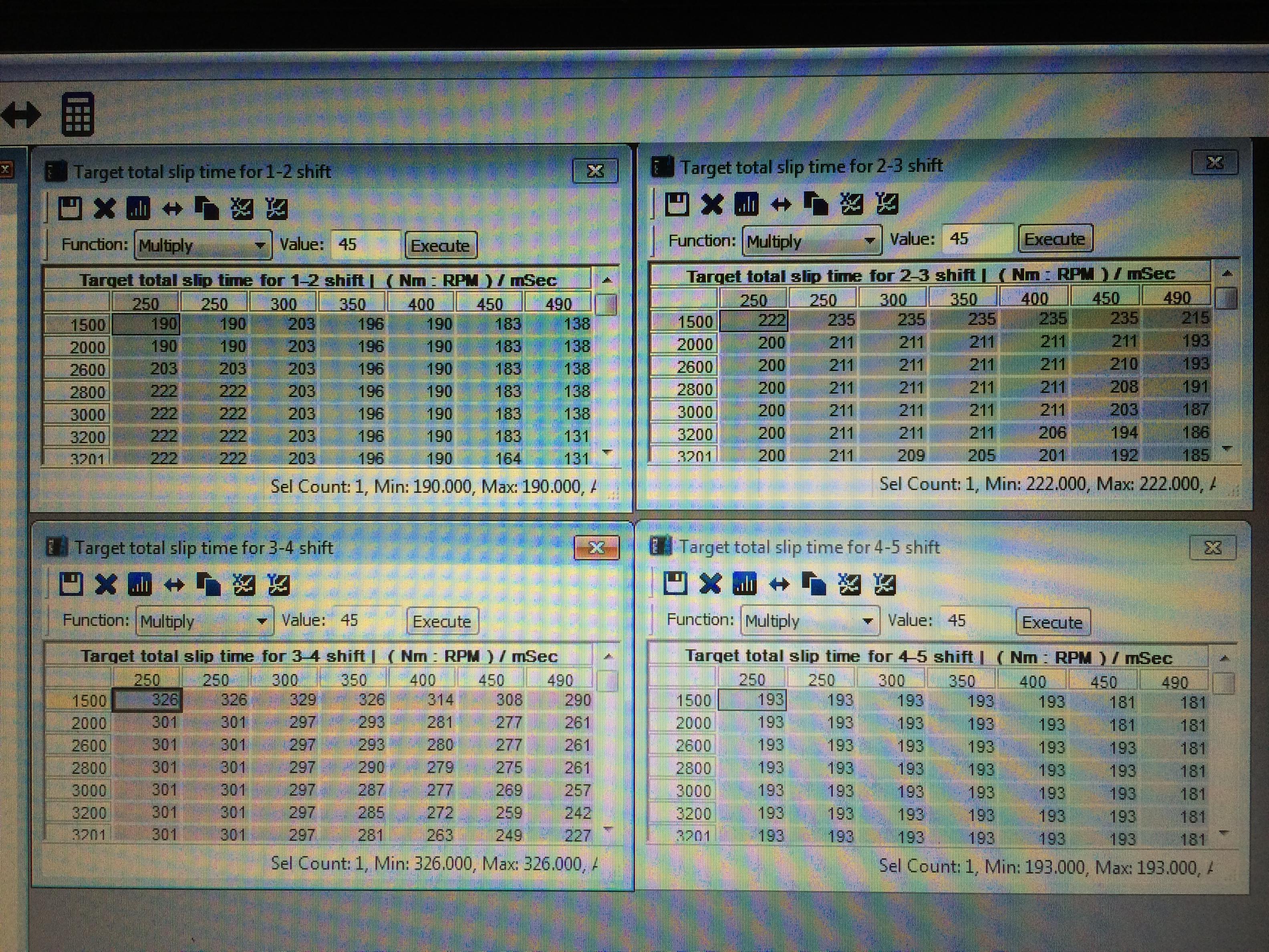

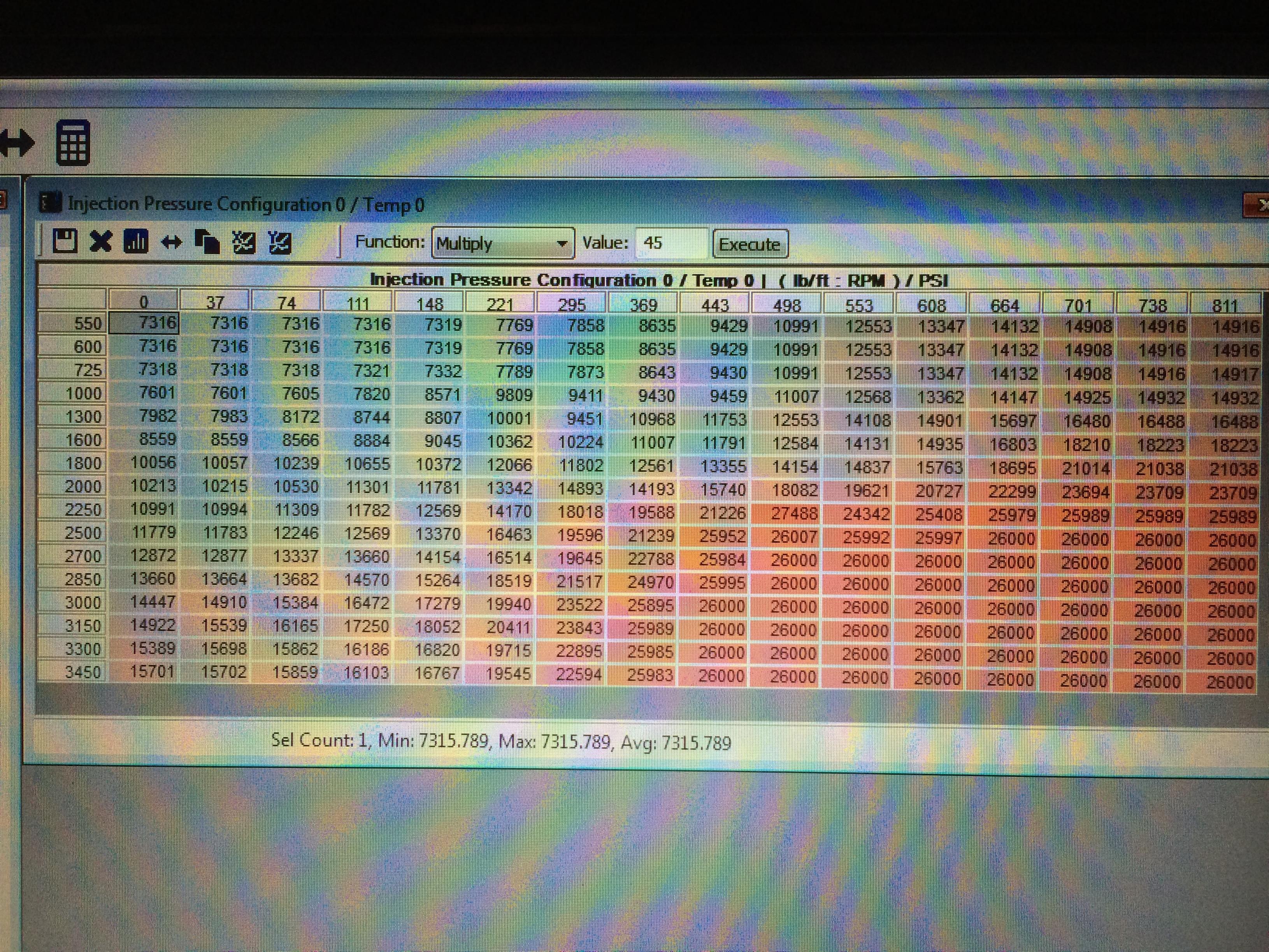

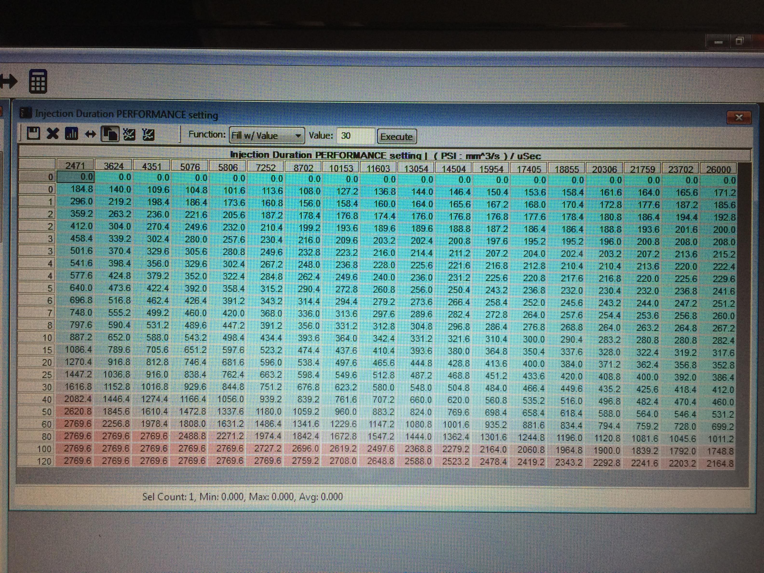

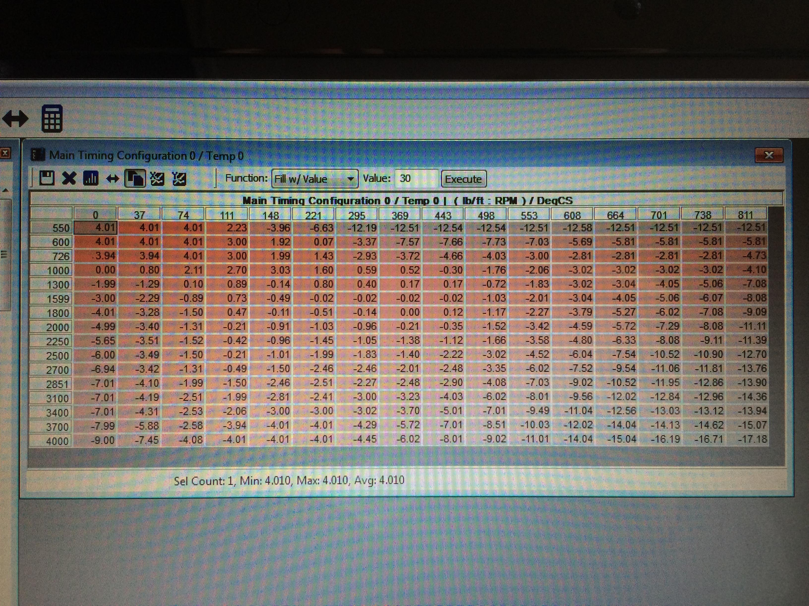

Even though some of this tuning may only be applicable to my situation I wanted to share it. Dustin has been a big help as well as the info others have shared in this topic area and the only reason I can share any of this is because of the info that has already been shared. This is just a start, I will continue to add info as I refine the tunes.
My base file is the hd300, low end fuelling on 5. Important engine components... 366 hp turbo, 2 362 lp turbos. Elite 8 hole 110 injectors. Dragonfire hpfp. Comp cams stage 2. Trans components... 2200rpm stall, sun coast trans.

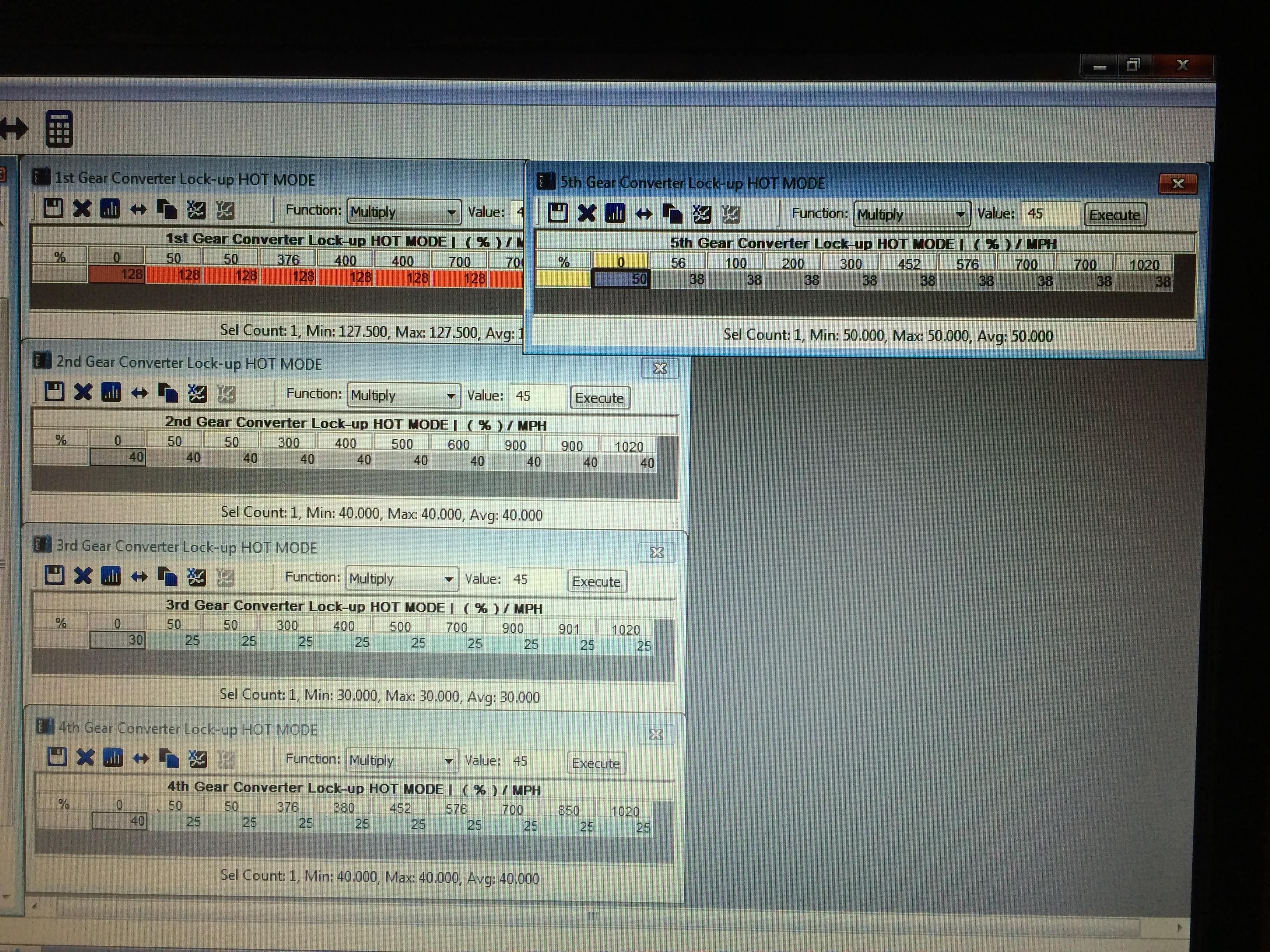

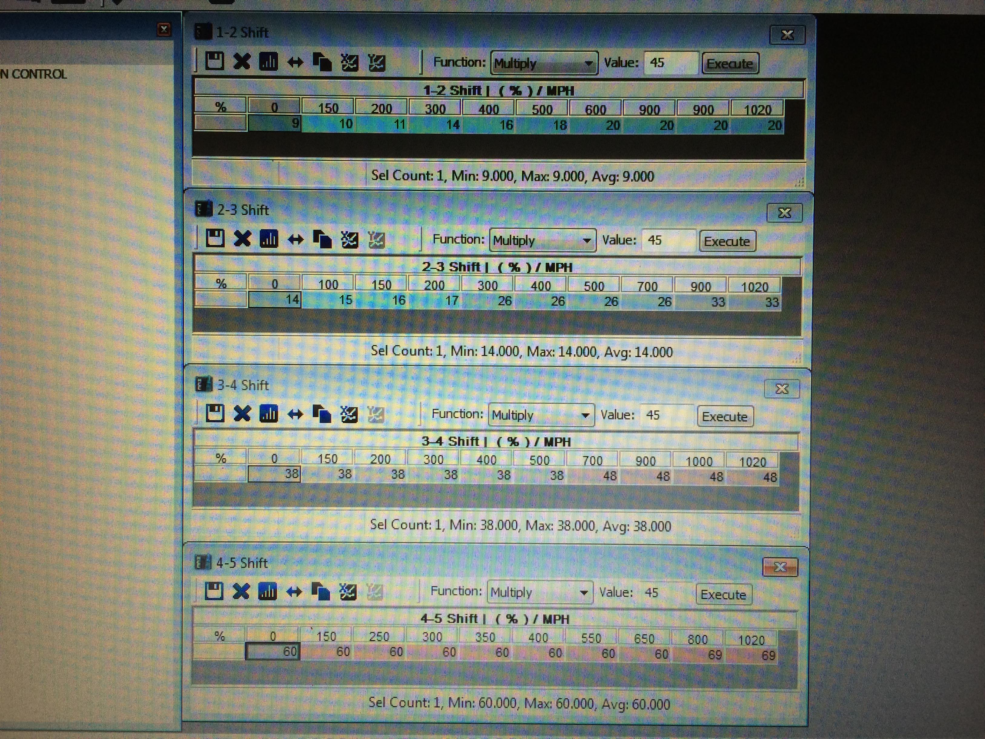

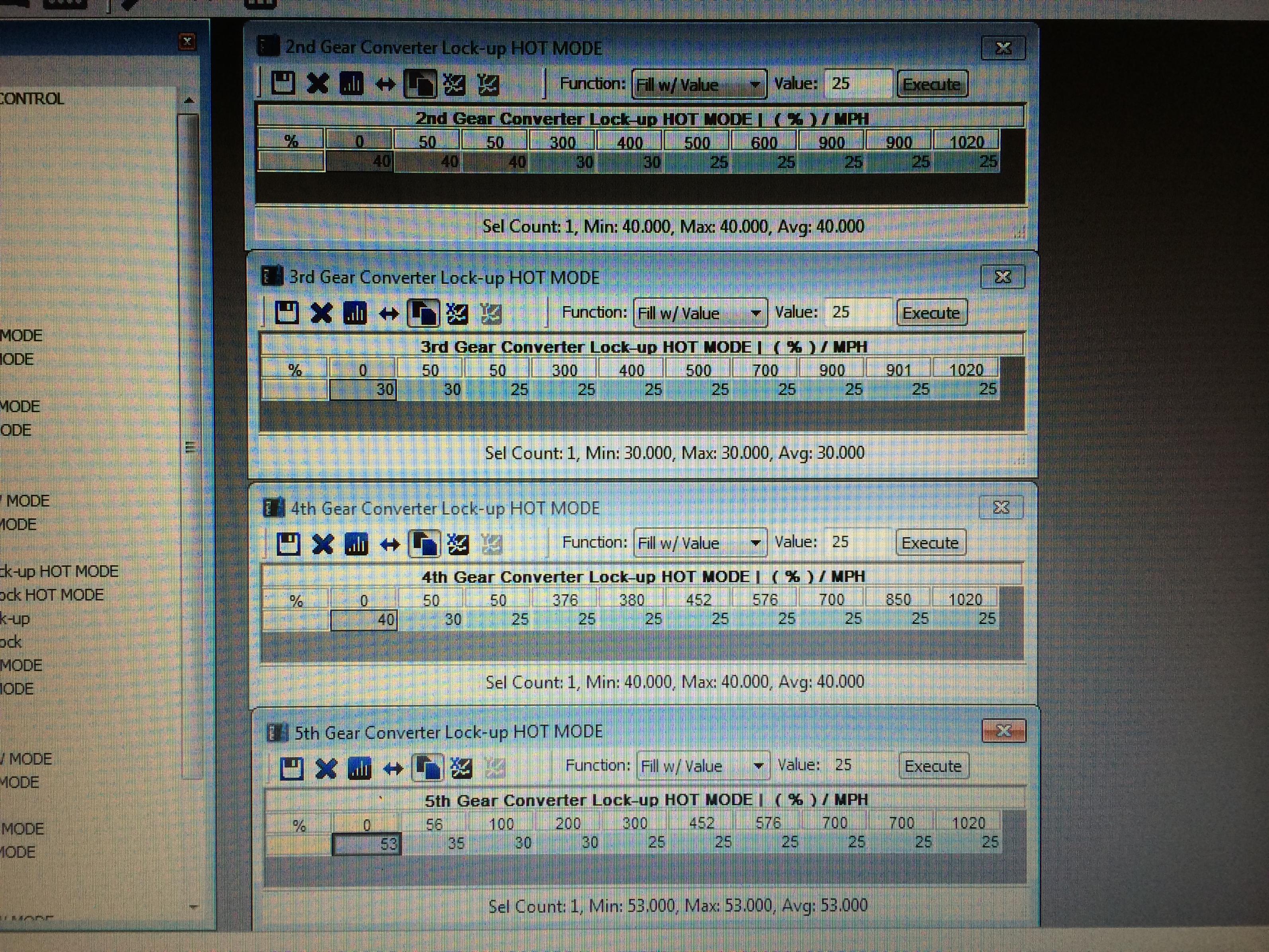

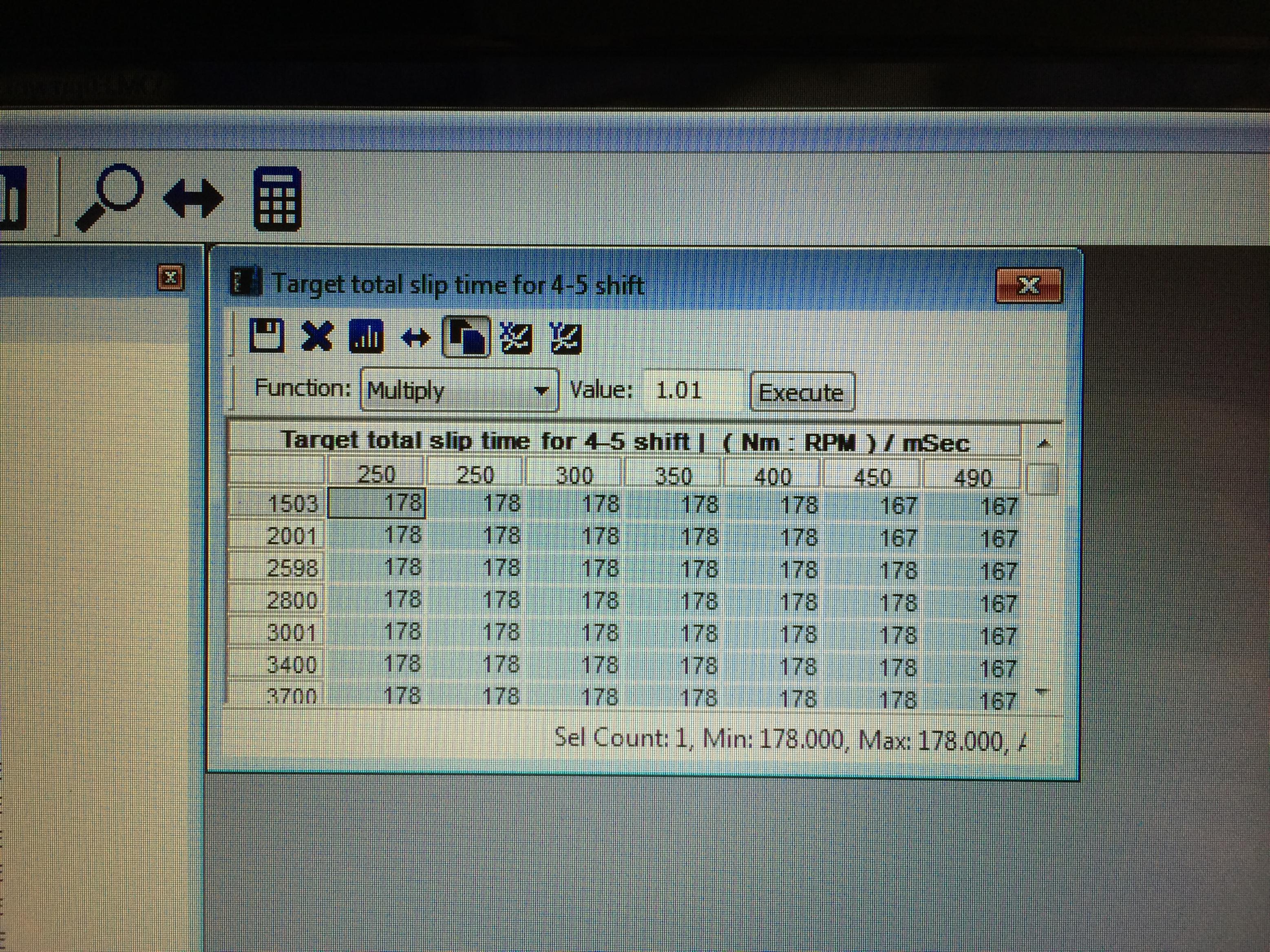

My predominant issue has been the tc lock up. At first I switched back and forth with S1 and S2 with no success. I found the commanded throttle input for lock up was way to high for my truck. I lowered that setting then found out I needed to readjust the shift points based on throttle input as well. I also adjusted the slip time during shifts down 20% across the tables. Then set my WOP shifts from 3200-3400 to all being 3700. So far I'm much more pleased with the trans performance.

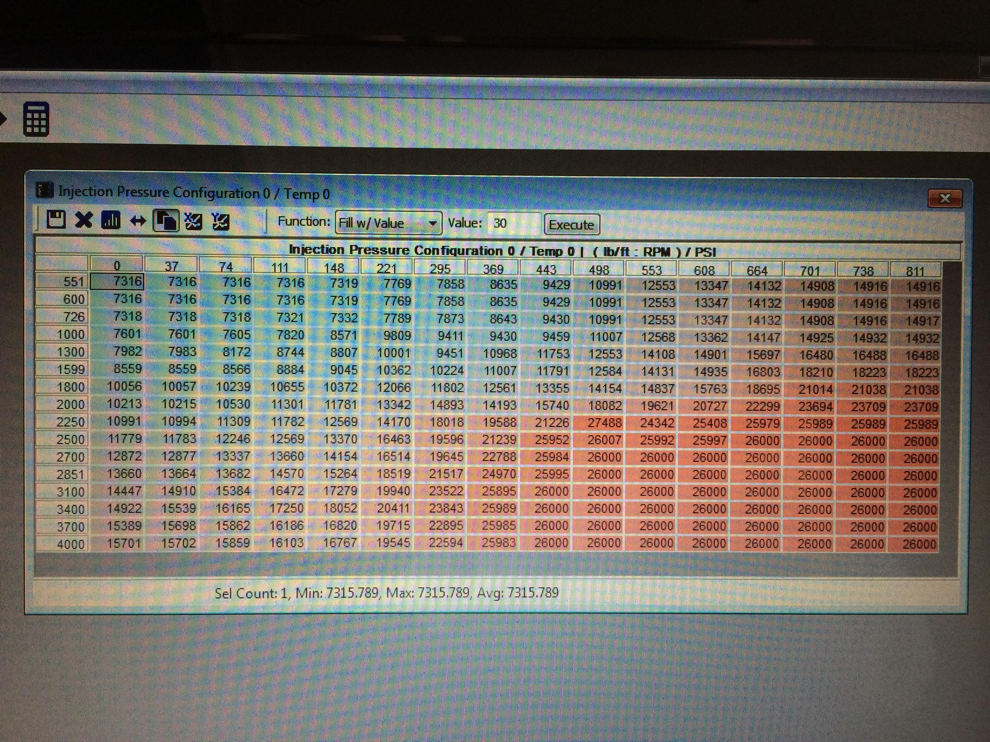

Now with the hd300 I initially started on the default low fuelling at 3. I was less the impressed with initial spool when accelerating at highway speeds but once it got to 8psi the truck woke right up. So I assumed I needed to lower the low end fuelling. I went down setting by setting from 3 to 0 getting better response the lower I went. Once I got familiarized with mcc I rescaled boost to 50psi. Readjusted my transient and steady as suggested in Haller's thread. Went for a drive and was very unimpressed. Smokey and very laggy. I was frustrated after that lol. Next day I said *** it, I decided to to start with the hd300 with low fuelling set to 5 as a base. All I did was rescale the boost to 50 and went for a drive. Instantly was a much better drive! Spool was way quicker and smoke output was lower. I then readjusted the fuel psi, predominantly raised idle to 7300 and capped overall to 26,000, then smoothed the table. That adjustment alone made a big difference in response. Initial smoke output during spool lowered again.
At this point the truck is a whole new machine from the day I drove it home. It has become very responsive... Every bit that trips are bragged about! At the moment the way it pulls from idle would probably still get me a 2 second 60ft lol. Once I'm 100% happy with the trans shifting I will be refining the engine more through timing and pw. I've been reading up on timing and it's importance in custom builds more then anything. Maybe the base hd300 has it close... I'm unsure until I try tho lol. There is a possibility I could make the turbos more responsive and get more out on top. That would be fun! lol
Here are the tables I've changed. Sorry for the screen picture lol. I couldn't get the screen shot function to work on my borrowed pc.

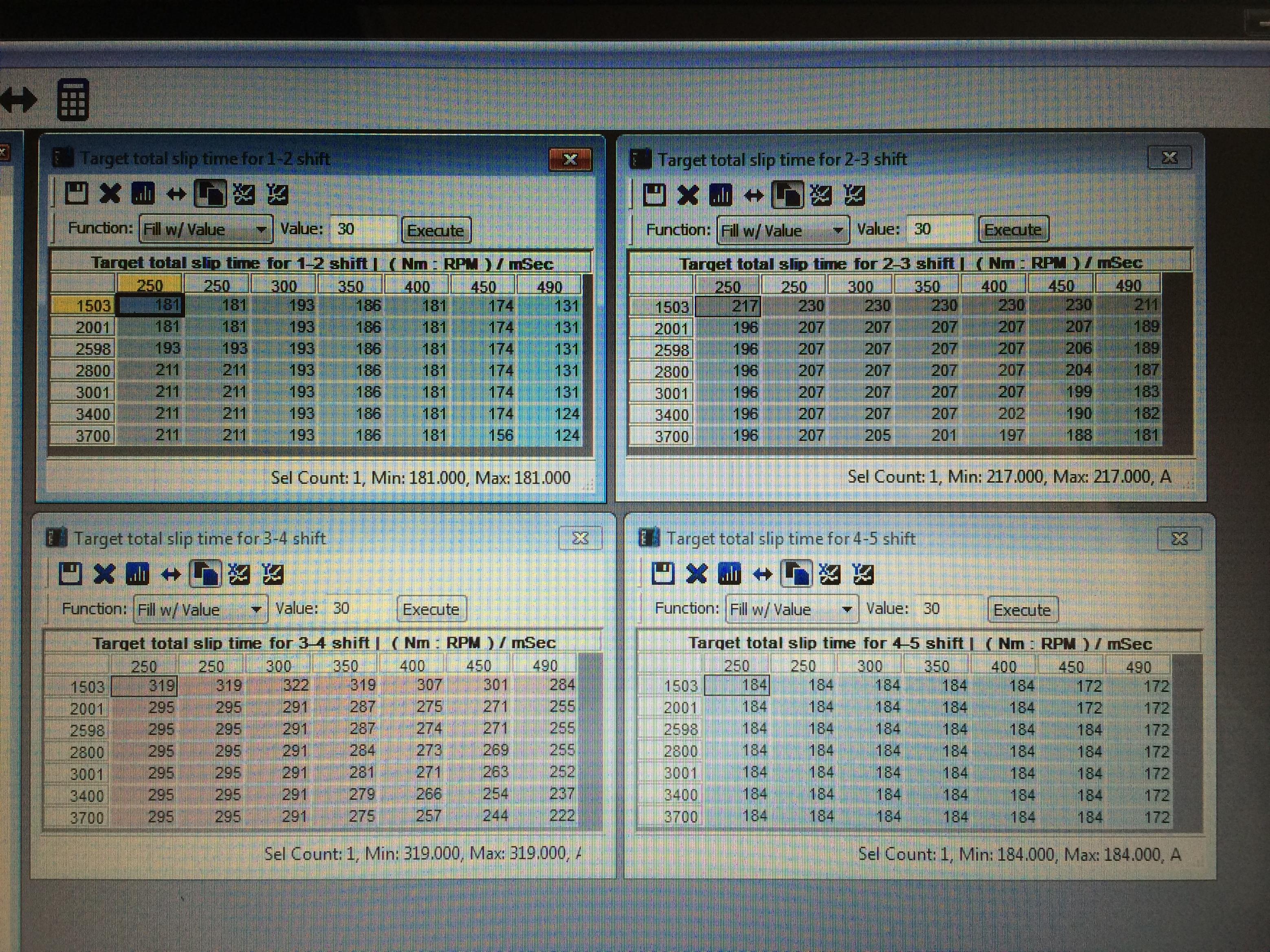

Refined the trans some more. Shortened the shifts another 5% then rescaled peak shift rpm from 3450 to 3700. For the most part it is now shifting and locking up the tc making a lot better use of the power band. Still have some fine tuning as well as refine the down shift tables more.
I dove into the motor a little more. Mainly rescaling the rpm axis for the duration, injection pressure and timing tables to 4000rpm. I also retarded the timing in the upper rpms to -17 and below from -18 to -20 that was there in the box tune. Also smoothed it out.

I love the capabilities of the mcc tuning. Mine is a stock hd 300 base file s1l tran tune with some help from Dustin on the trans tuning. Basically we lowered the slip timing as well. Going about 20% lower at a time on all and then tweaking each one to even it out. Never messed with any pressures only slip time. It shifts great. So good I have mcc on all 3 trucks and the sames trans tuning on all. Nice firm and quick shifts but doesn't break your neck all the time. We also tweaked the lockup on the last gear where it locks up directly at 45 so it isn't in and out driving around town. It locks in And goes!

The rail pressure from what i have found make the best additional response as well as better smoke control. I try to make the truck not increase pulse width untill rail pressure comes up, so when you give it more throttle the rail pressure comes up to around 20k before the pulse width increases much beyond .9 ms

My next step was going to be rescaling the fuel pressure some more. Even tho from a overdrive pull I can get into it really quick and it will belch pretty thick smoke but it cleans up really fast.

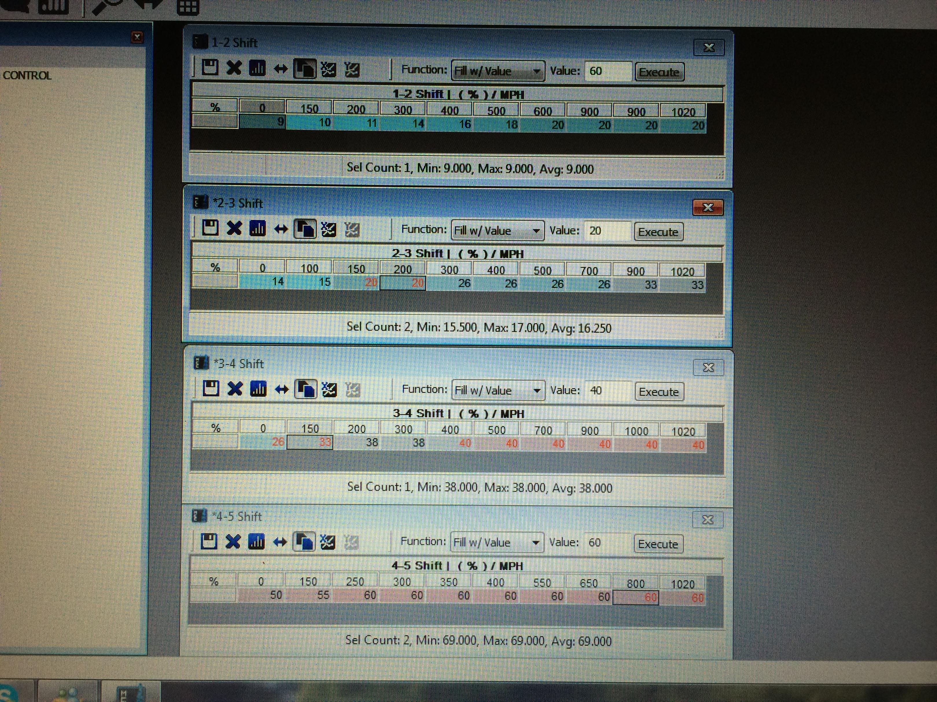

Today I changed the shift pattern a little bit on the 2-3, 3-4, 4-5 tables. Then altered the tc lockup to accommodate the shifts based on how it drove. Quickened up the 4-5 shift 5% as well because I wasn't happy at all with how slow it was.
I also bumped most of the fuel rail pressure table up 5% and lowered the idle back down to 5500psi then smoothed.

Got a quick question. When shortening shift time say 20%. Do you enter in -.20 or is there another format? Also on line pressure. How do you enter percentages +or- correctly. Just want to make sure I do it right if I ever mess with it myself. Thanks.
Kind
1,498
You can use the multiply function. Then as an example you either enter .90 to take away 10% or enter 1.10 to add 10%.

i think you need to raise your shift points to at least 3500 rpm, your dropping below 2800 on the shifts and i can almost bet thats under the main power curve on the dyno
Kind
1,498
Yeah, you're right. that's what I changed yesterday but haven't been able to test it yet.

I also retarded the timing one degree from 2500rpm and below and waiting to try it out as well. And ramped the frp up a little bit quicker.
