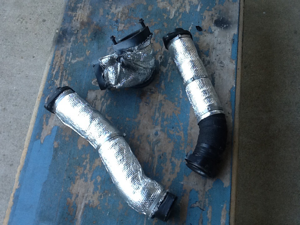

Wrapping your new bellowed up pipes will keep the heat in them and get rid of lag. I really like BD stainless.
