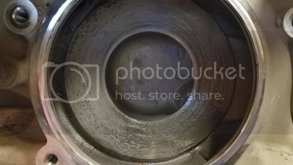

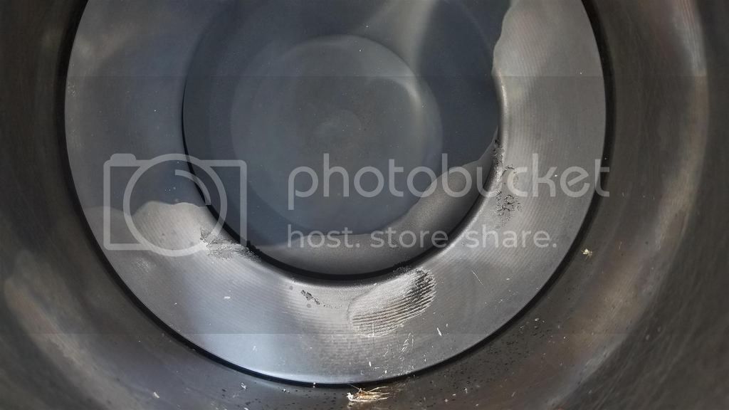

That's a rats nest in there for sure. Also I think the clean spot on your piston is from fuel dumping in the cylinder when you pulled the injector. Fuel is a pretty good cleaner and when it soaks like that it will loosen up all of the carbon.

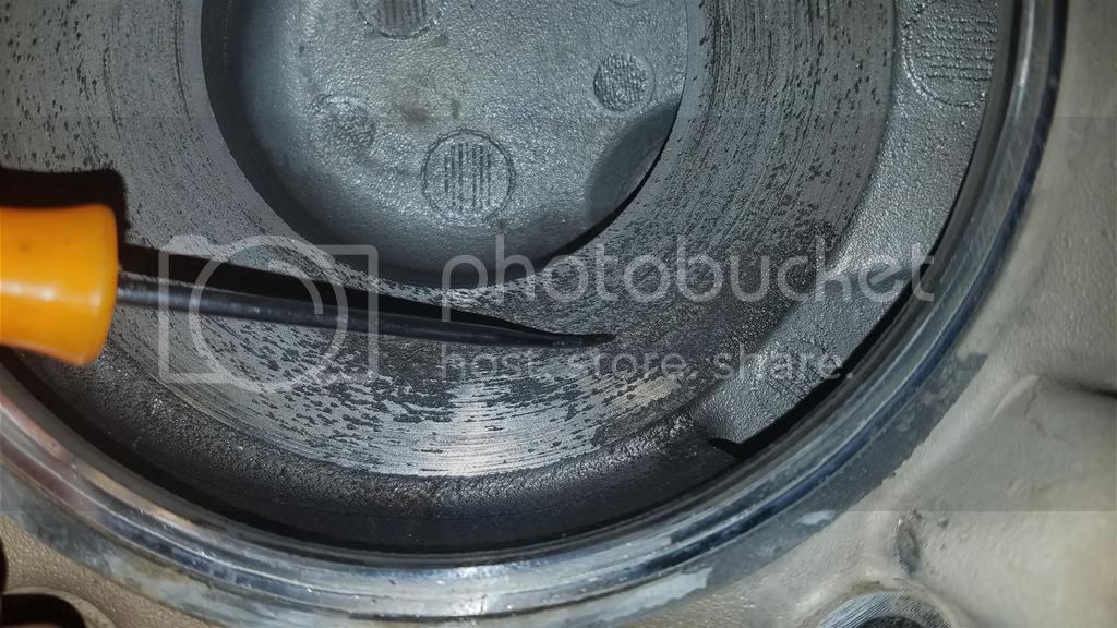

That was my thought as well, except it is like fiberglass insulation, which made sense keeping turbo heat off the top of the engine, but still seemed odd. lol No idea when that could have happened, likely way before me, but with as many miles are on this truck, it never sat very long.
I pulled the head before pulling the injectors, so the tops of the pistons were dry. The front piston had a similar look to it, but not as pronounced. I'm still not quite sure what to think of it, mostly because the coating on the piston seems to be flaking off or something. I need to look at it closer.

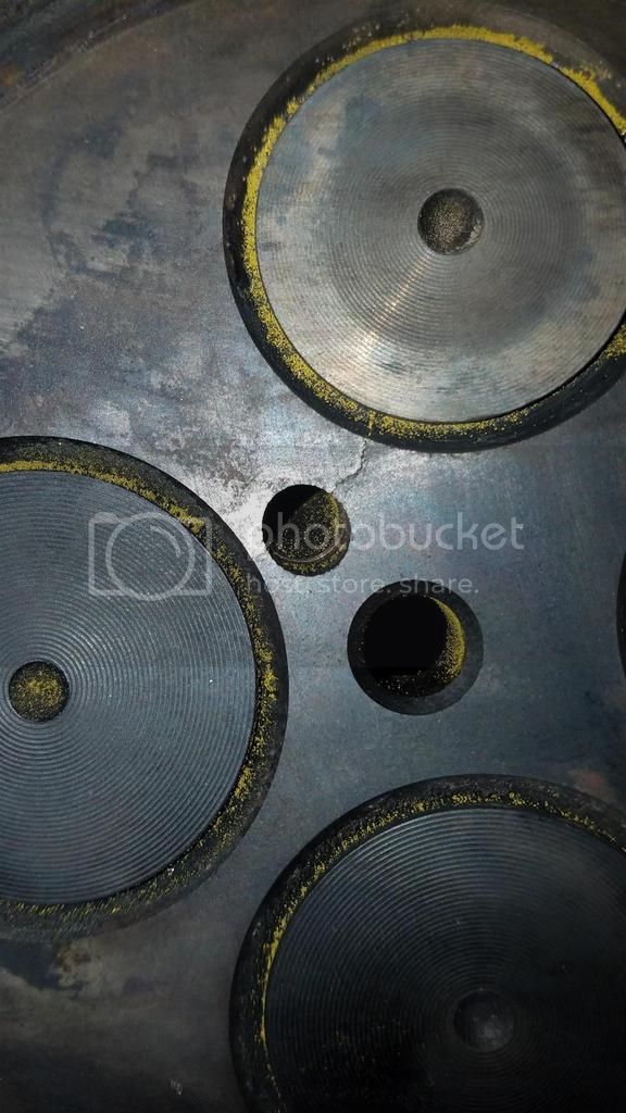

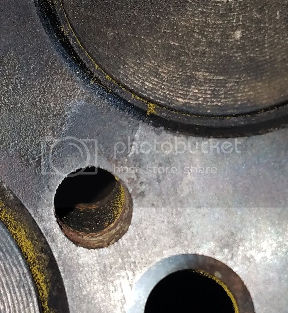

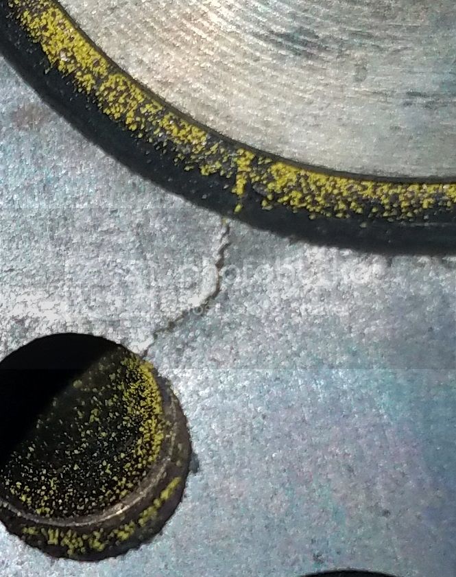

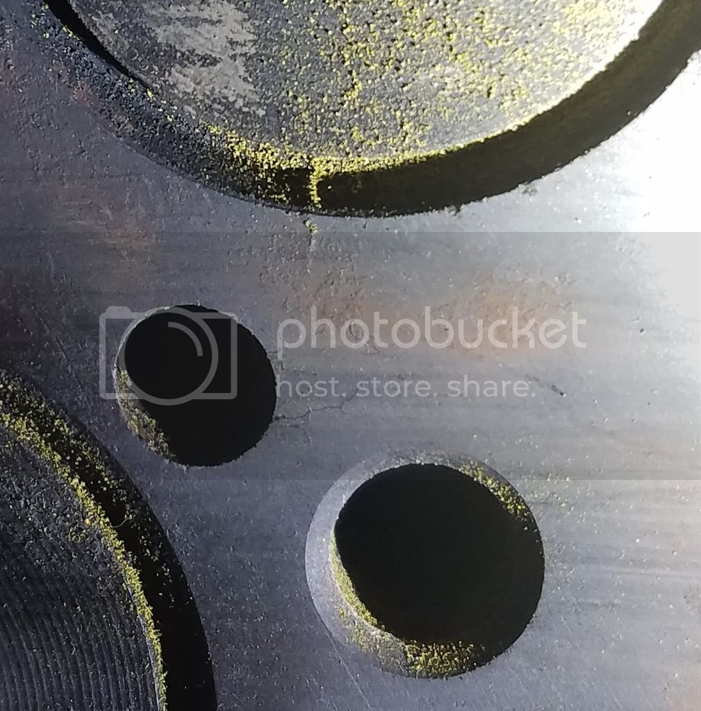

Welp, expected news from the machine shop, these heads do have cracks between the valves and over to the glow plugs. I was told up front that they will replace them if they have cracks (additional fee of course), however they got screwed on a set recently and now refuse to deal with them. All the local diesel shops are saying they buy straight from Ford and "usually" end up with new heads and they are good. One engine shop says they use "Pacific" heads, which best I could tell was a new casting with my valves and such, but seemed really high. I'm thinking straight from Ford is my best bet, thoughts?

you wont get new heads from ford, only reman. And typically, when inspected, they are in hardly better condition than the ones you just took off...
I hear you, and understand, hence my concern. From what I am being told locally though, about 80% of what they get from Ford are new and usable right out of the box. The other 20% are remaned and need some minor work before running them.
What's my better option if not from Ford directly?

UCF I think would be a good option.

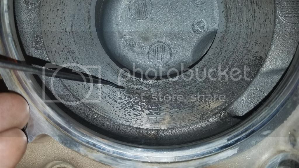

First off, the coating on the piston is interesting, but effectively nothing. I looked tonight and the line had progressed upward and even more appeared to be flaking off.
When head was pulled:
2 days later:
When I touched it with my finger, it wiped right off and appeared to be wet to the touch. Kinda interesting, but no big deal.
