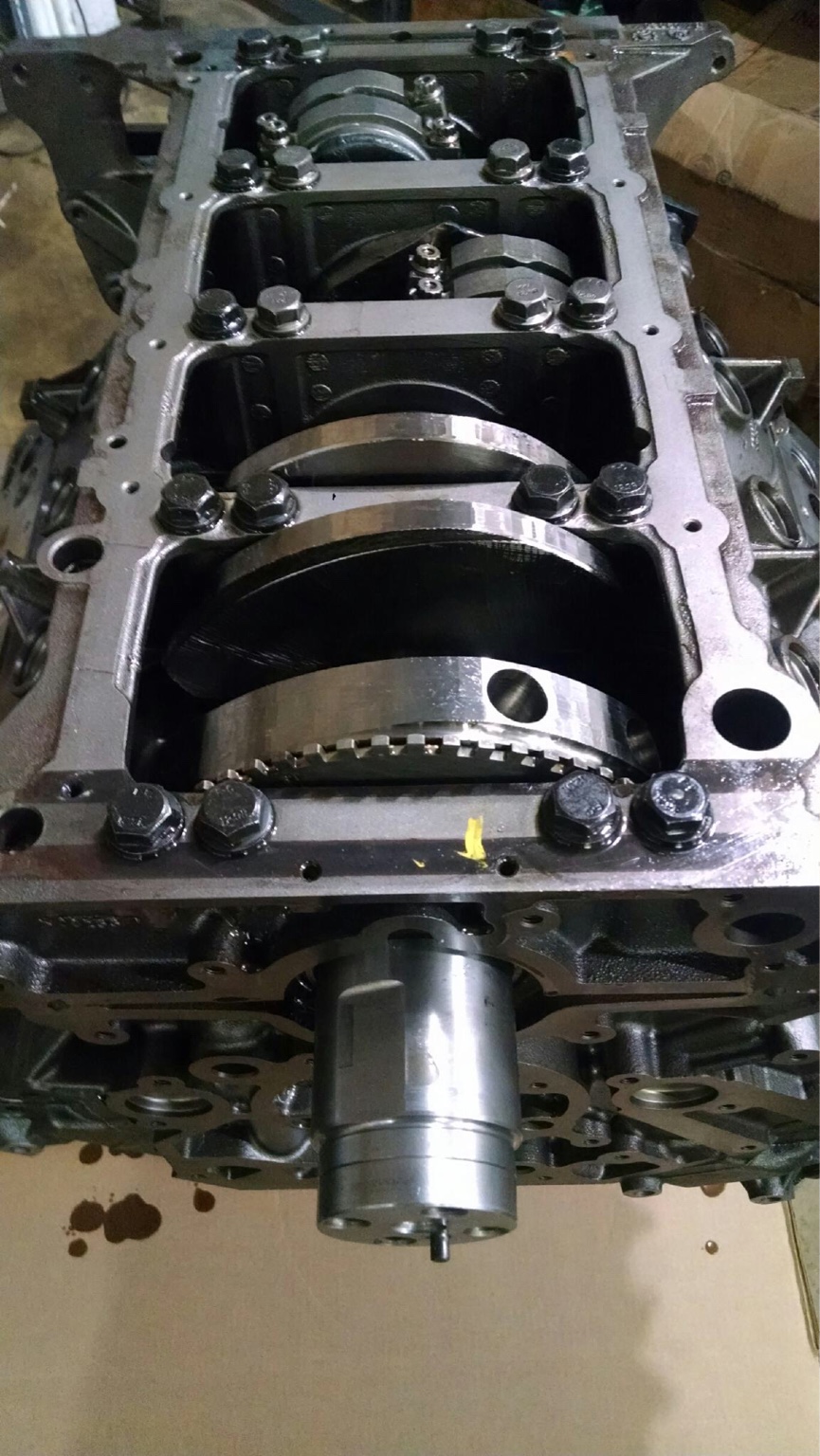

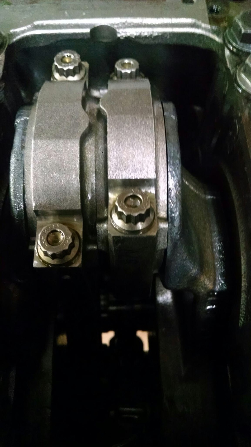

It's been a while but we are getting closer to having the truck back together. Been spending money like its water and getting parts around! IMG_0076.JPGIMG_0075.JPGIMG_0078.JPGIMG_0077.JPG Another big thanks to Mike at No Limit!

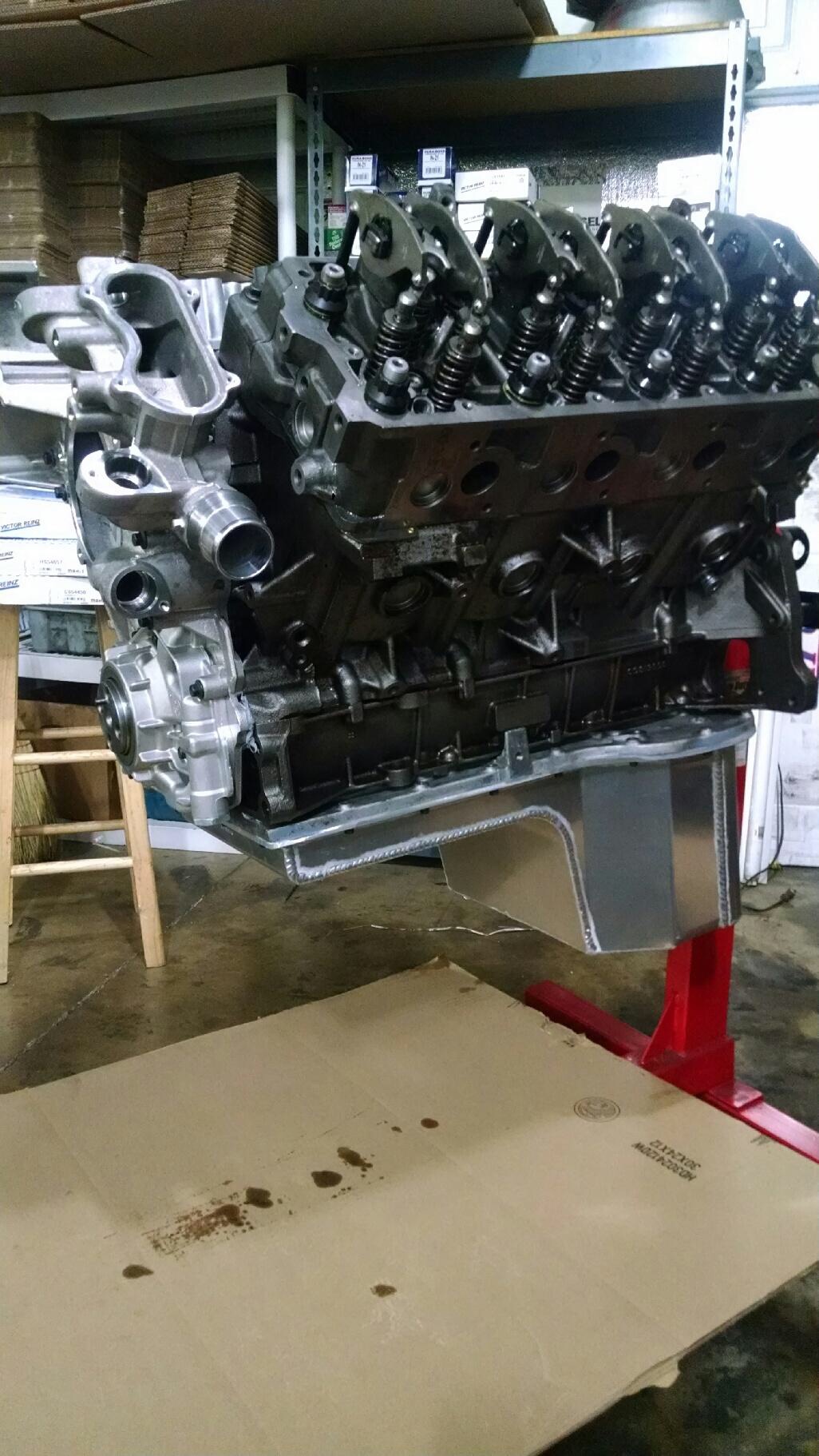

RCD Pans are the way to go. Light as hell, look beautiful and hold up well too. Going on 18 months with mine and over 20k miles with it being powdercoated, not one rust spot or chip or leak or anything. Awesome Pan.

I'm leaving mine raw I like the look even though I'm probably the only one that will notice it.

Well you shouldn't get any rust... Because it's aluminum! LOL

Two cracked Pistons filled the oil pan with fuel and the compression blew the pan off.
Tore it all down and started over.
.20 over ih delipped coated Pistons
New heads
Billet push rods
Hd valve springs
Stock rods with arp hardware
Hd lifters
Ported intake
Rcd 71/59 turbos
Midwest dual fuel
30 over nozzles
Marty's fuel system
No limit intercooler and everything else
Mishimoto radiator
I'm sure I missed something but that's most of it

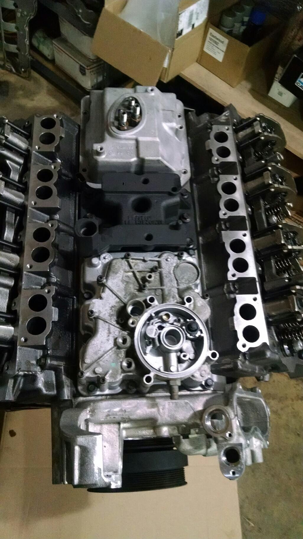

Picked everything up yesterday will be putter her all back together these next couple of weeks. Been without my truck since May I'm ready for this bitch to be back on the road!

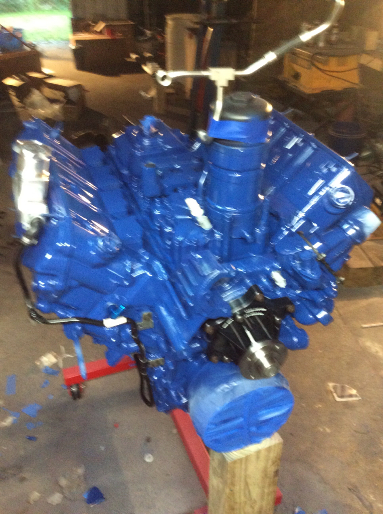

Making some progress got it all painted and fuel lines all ran how I like. Still working on gate plumbing should have that tomorrow
