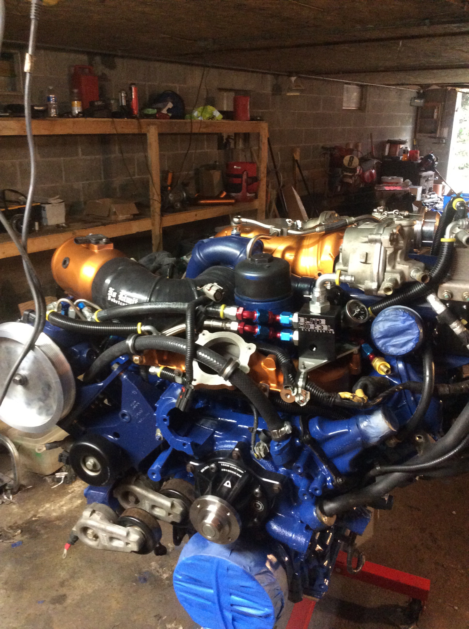

Things calmed down a bit and I was able to work on it. Think my best bet is to just get it running as I don't have many options for moving it. Was able to get the engine in and bolted up to the tranny today and got the turbos and gate all mounted up. Now everything is open and on the front of the motor I should be able to get it done in a day. I post up some pictures tomorrow.

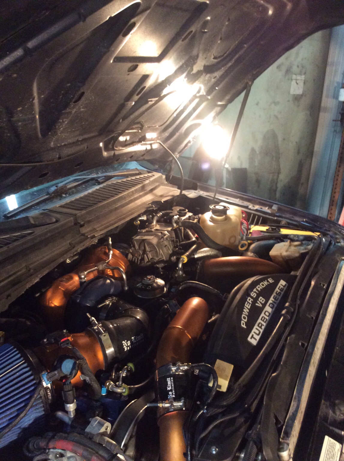

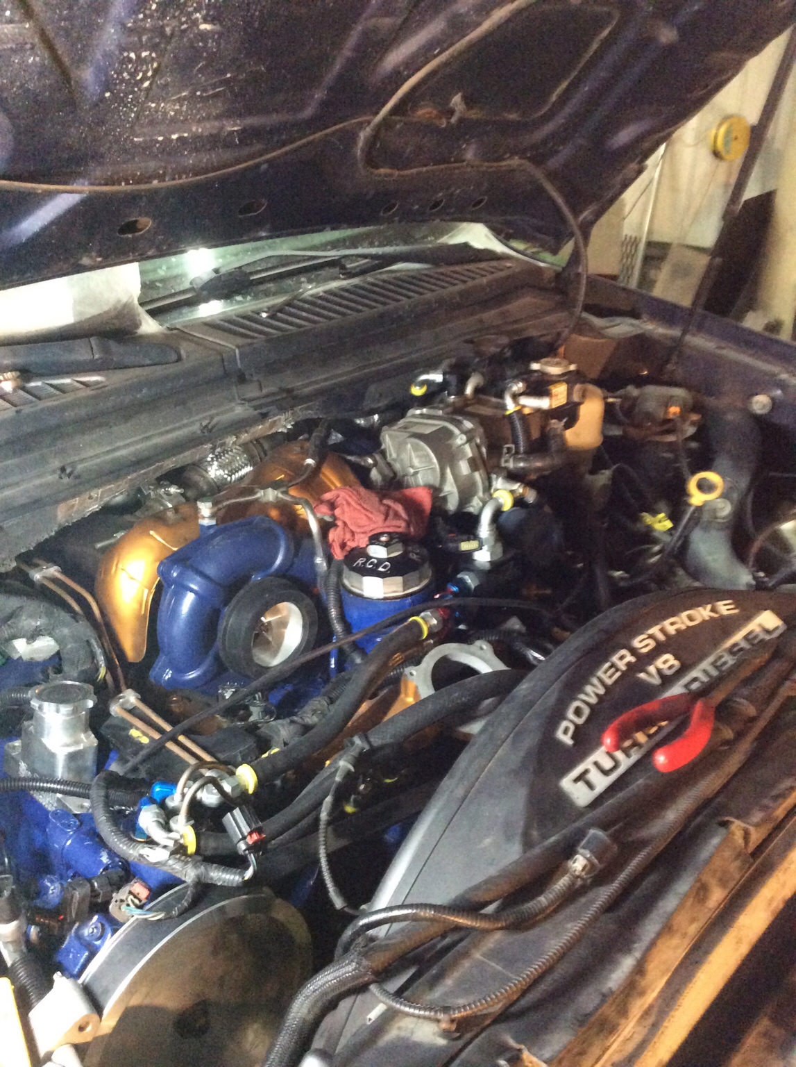

Everything has gone together nicely and she is ready to fire. Can't seem to get the mini to cooperate though. Was really hoping to drive it tonight.

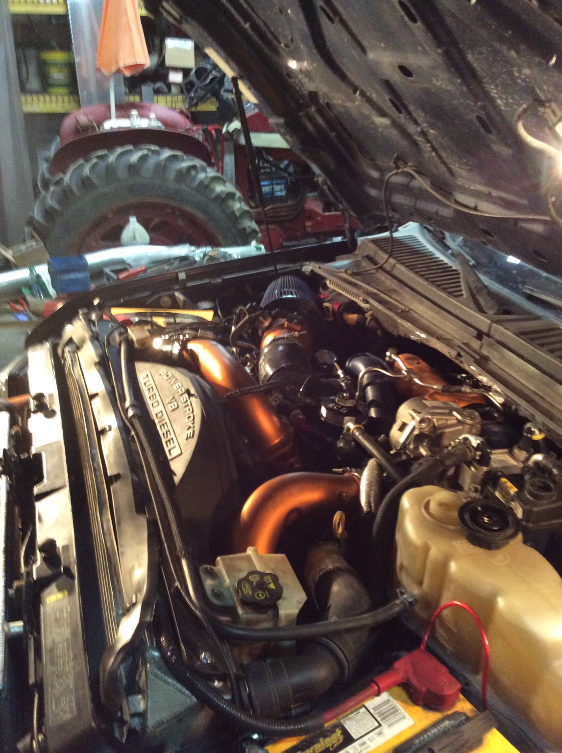

Truck seems to run great, needs a little tweaking but I am very happy! A little advice to everyone else DO NOT USE GRADE 5 BOLTS IN YOUR CONVERTER! I sheared off all of them. So next weekend I'll be pulling my trans so I can fix that cause I was in a hurry and thought I could get away with it
