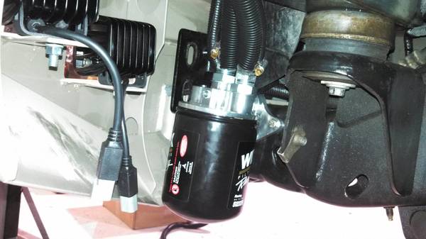

why do you need a billet oil cap to monitor oil pressure? are there no lpo ports on a 6.4?

How would Erik and I be able to do this if we have the filter relocation from elite? Curious as I'd like to maybe do this when mine is done
There almost has to be a port some where we can tie into. On the oil filter cap i use a 1/8 pipe sensor and use the dashdaq expanded harness to tie into that. Unfortunatly since you can only have 2 you will loose one. or run 2 dashdaqs ect.
The edge cts does work well, it sucks on 6.7s just like every other monitor out there. but the expandability is awesome so you would no loose any functions.
It would also be handy to see if a filter was in by pass or not as you could have a differential sensor in before and after the filter. but thats all really getting too complicated for what we are talking here. That would almost be better off being a switch and a dummy light.

You can see the pressure port in the pic here Erik.
x2 on the CTS. Erik's got some nice analog gauges though, so going with a match on one of those would also be great
Erikclaw
May 21, 2011
4,877
Central CA
that CTS sounds nice, since you don't lose any thing that you want to monitor. I think that housing has two empty ports but not sure. I know there is at least one.
