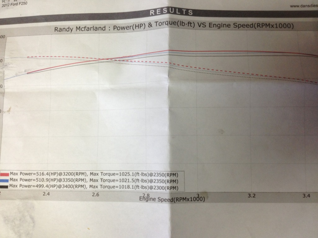

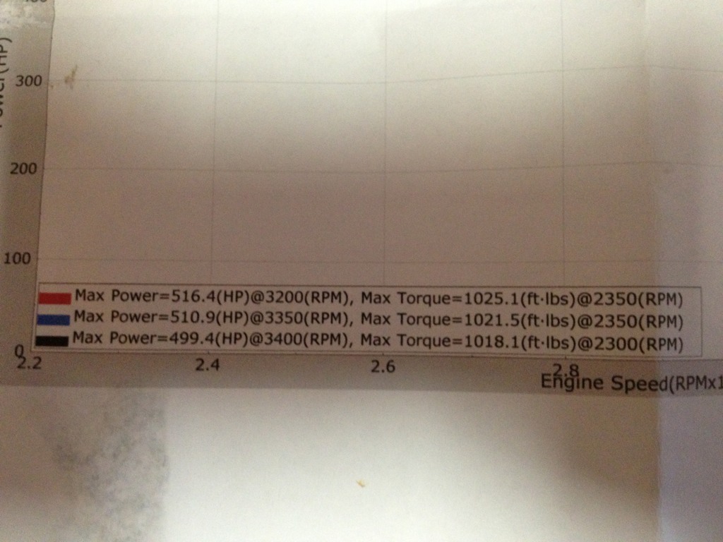

Here's my dyno graph. Stock turbo , stock fuel. H&S Tunes mods in sig best of 516.4Hp 1025 Tq.View attachment 18591View attachment 18592
That sounds right.
Same dyno truck to truck we have found tthat the header and fixed turbo upgrade add around 40 rwhp, lower egt's about 200, and pick up dome mpg's.
I would expect very simalar results with all kits.
Thanks for the baseline numbers.

Every kit is making different numbers at this point, I'd say its best we not try to categorize them all.
Looking forward to the numbers Jared and his crew come up with over at RCD. Chop chop fellas!

That 516 on a stock truck is just a tad high for me to really believe, not trying to start anything but that had to be a very forgiving dyno to make those #s
Mike@MPD
4,782
Pasadena,MD
Just talking to Eric the average power on a tuned deleted truck on his dyno is around 460-470 and he's done a lot of messing with the 6.7
