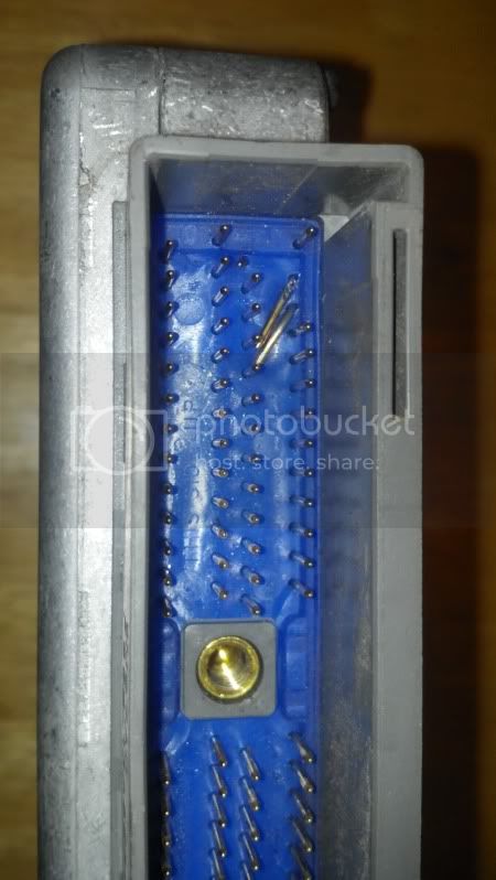

Just repulled the pcm...2 bent connectors and one pushed in. :doh: Anyone think its possible to bend them straight and pull the other one out and have it still work? What about a new PCM? Wheres the best place to get them?

I was able to bend one back straight, the other one is pretty badly bend but I might be able to get it straight. The one that worries me is the one pushed in. I hadnt pulled the PCM since installing the injectors I had simply made sure that the connection was tight and had been focused on the connectors in the engine bay instead.

Got it running and preceeded to blow boots the first 2 times I even got one it. Once in my modified stock and once in my daily driver. Holy ****.
Heres the pics of the PCM Pin connector
Before:
After:
Just used a pair of needle nose pliers and was able to straighten both pins and pull the third one out.

As I said....It was the bent pins in the PCM connector. Started right up after a couple cranks once I fixed them. Injectors fired the first crank then it was just a matter of them actually catching. Still wondering about the chip issues....when I change position it seems to studder for a second...and when I put it on what is supposed to be high idle it sets an ses light and kills the engine. Not sure what the ses is.
