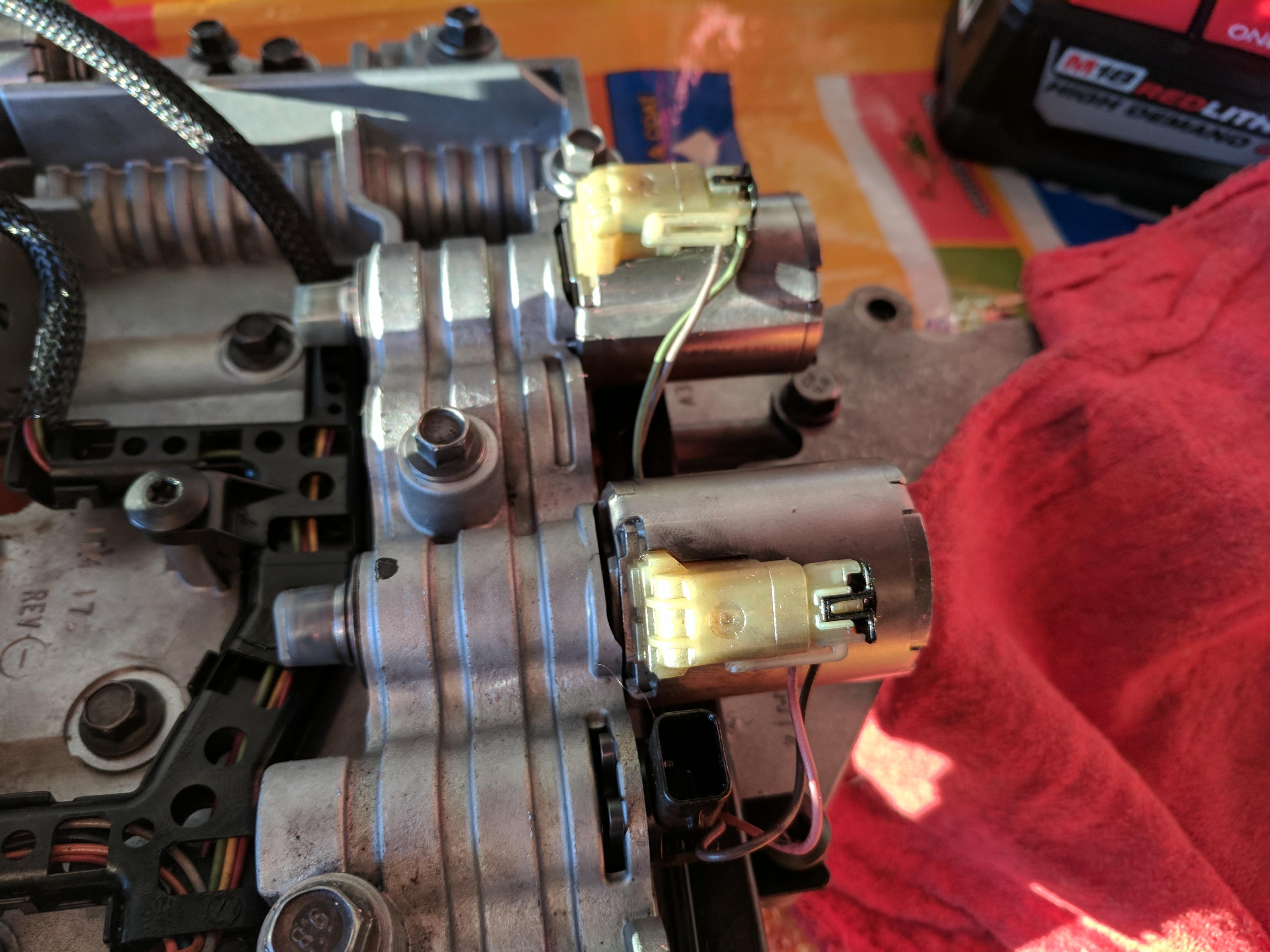

Hey guys trying to help my cousin with his 6.4. If I'm in the wrong section to post this mods please move/******.
I've attached a picture of his valve body. He's having some dtc's pop up on his tuner for a solenoid. He just got his trans rebuild done and he is having some shifting issues that are intermittent. He is now going to swap the valve body out for another one he had. Is the solenoid in the picture positioned correctly? You can see one at a different angle than the others and the valve body he is taking out all of them are aligned straight?
Any input is appreciated, thanks!

If it's a modified solenoid it's in correctly, if not then it's incorrect. That one is the direct clutch solenoid that is commonly replaced with a modified one. I would get new solenoids also though.

You are correct it is a modified one, thanks for your help!
