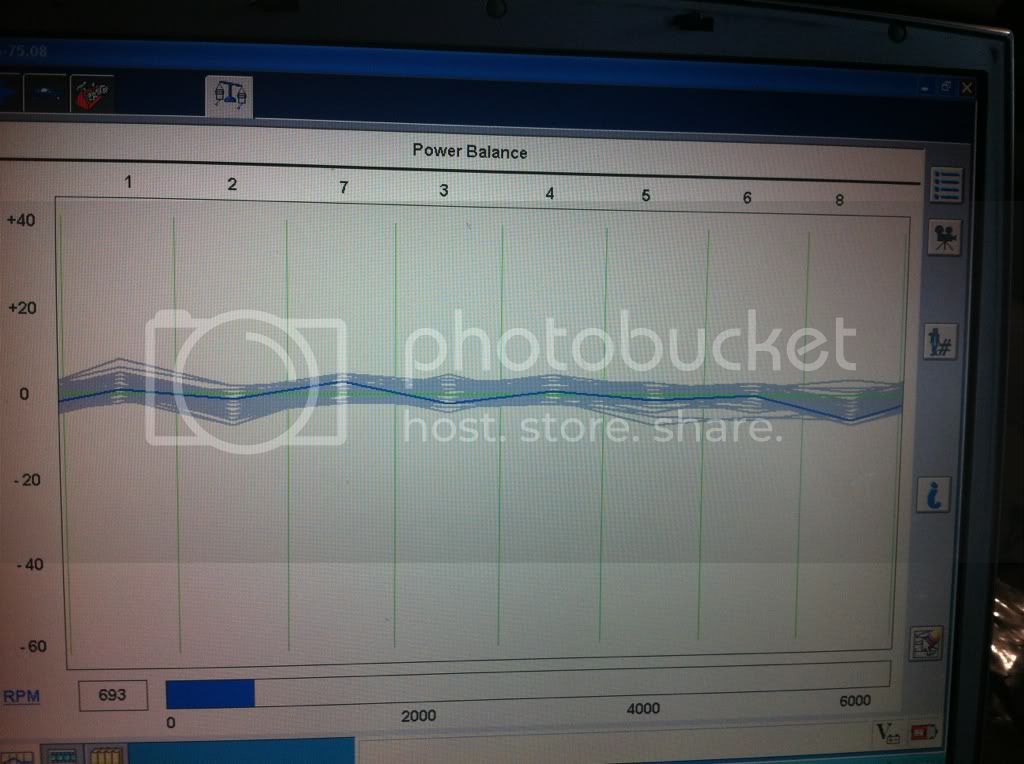

Yep.... and by the way the needle is bouncing, something doesn't look right..... The VGT duty cycle is locked once the EBP sensor maxes out so that needle chaos is something not combusting right.
oh, LOL...
no way was I reading 50+ pages...but when I saw a 'hazing' problem...had to assume it was at somewhere OTHER than WOT...
any videos are tough to hear...but in your opinion (Matt) is the damn thing hitting on 8 cylinders?

I was going to say do a contribution test, but I would think you would hear it missing.
That gauge flutter could be from using 1/8 line, mine will flutter a little bit when pushing 35+ psi.

It's acting like an imbalance at wot.

I am looking into something else this morning. To me the fluttering needle means one of two things:
1. Inefficient Combustion
2. Turbo out of compressor flow
I'm leaning toward 1 at this point. I want to make sure the FICM is allowing the timing I am commanding. If it is holding the timing back to say 11 degrees or so, this could be the issue if these nozzles are big enough to need more than that for a lead because of lack of atomization.
