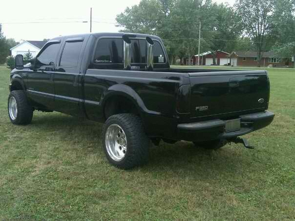

Here is my old 02
Two pics are 20x12 with 33x12.50 and the other two are 18x12 with 33x15.50 - All pics are the 2"front/f350 rear
