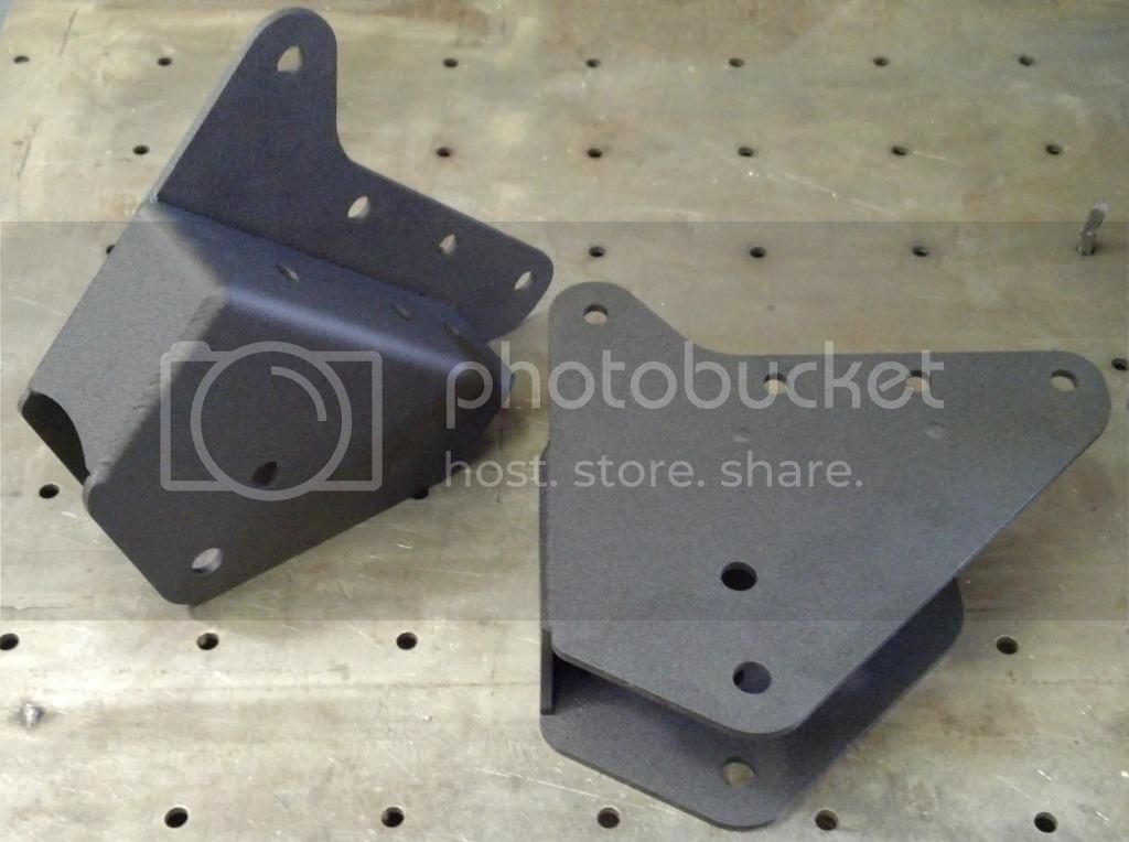

Well they are completed! They mount into place using all the same holes as the factory mounts and the supplied hardware. Retail priced at $399 and we will be running an introductory sale of $299! Let me know what ya'll think!

This wasnt originally brought up by my dealer. I had a customer call in looking for this part because of his local dealer telling him about it. I spoke with my local dealer to confirm/deny it and he semi confirmed it saying they had seen a couple failures aswell.
It is what it is, this is just an alternative to the cams.
They can also be used on trucks wanting to use a 3-link on a truck with a 7-9" lift.
