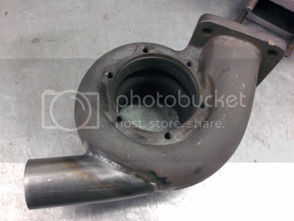

I've waste gated a Hypermax T4i mount for Luke's turbo setup. It came out real nice except for one clearance area on the tube that I am not very proud of.
What are you looking to know?
BTW - Charles installed his gate into the turbo housing....
Yea, thats what I've been told about Charles' 38r, but for some reason I thought it was in the collector, not the housing. So a hole was cut and a base welded to the housing? Where exactly? That seems easier than trying to fab a whole new collector/uppipe setup.

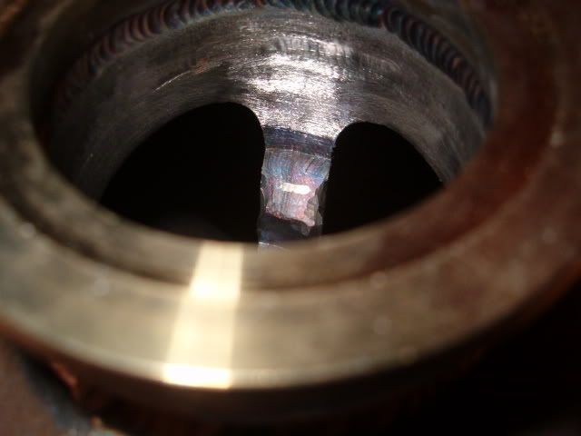

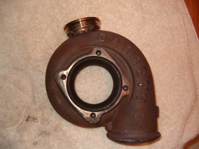

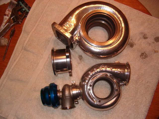

Yes a hole was cut and welded to the housing - It was done at a convenient spot on the outside of the scroll as close to the inlet flange of the turbine as possible. I know there are some pics floating around.

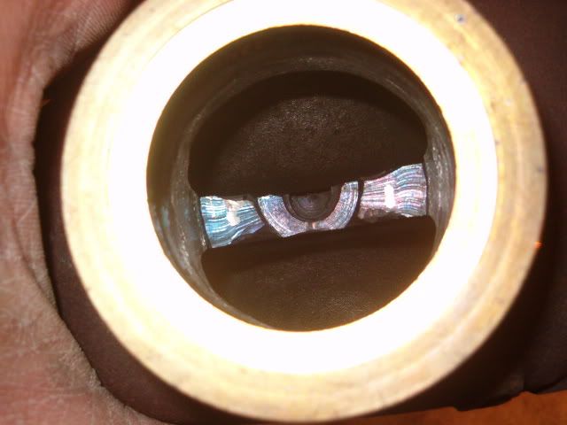

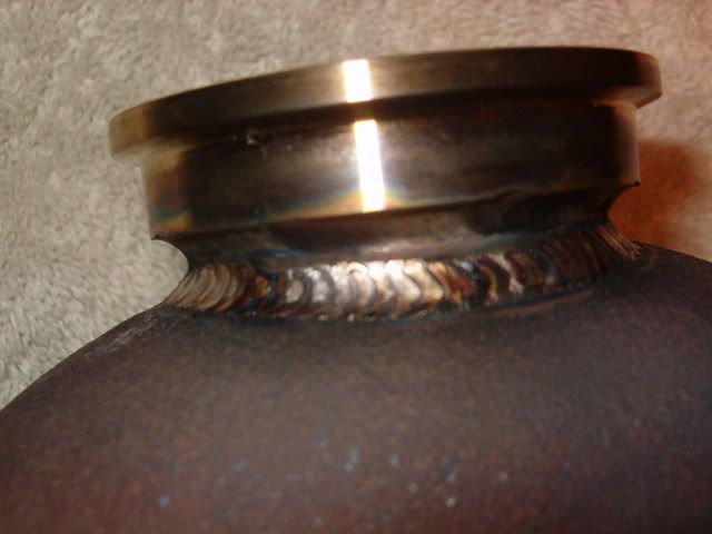

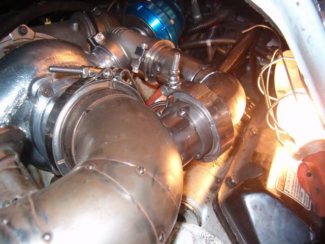

This is how I did mine.

I'm not a turbo expert by any means, but looking at that it looks like it would affect the performance of the turbine by affecting the airflow through it? Turbulence?

Yes its a V44 Tial that has been discontinued and replaced by this.
http://tialsport.com/prod_wg_mvr.htm
If you look at the pics in the link you can see what it comes with. I got mine from www.amsperformance.com, but I am sure a sponsor could hook you up.
