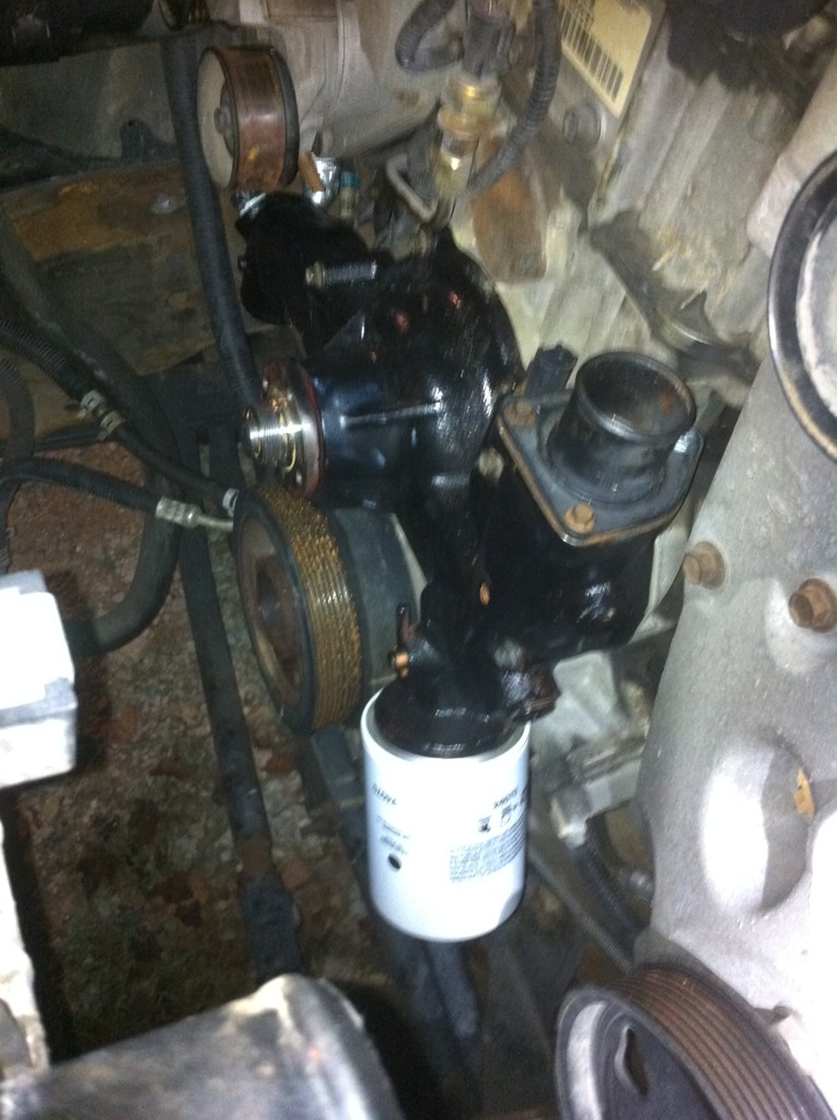

What temp stat do you run? 203 or 205
Here is my pump back when I did it.
Pretty simple job.
