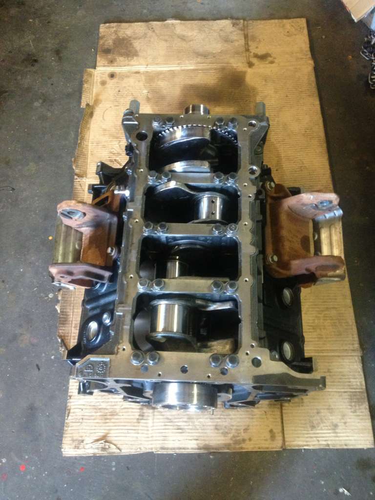

Nothing much going on today. Got all the parts washed up, block washed up. Once ford delivers all the parts tomorrow I'll begin reassembly of the short block. Then install it in the truck and get everything bolted on.

I initially did all the upgrading on the stock bottom end original engine. Block cracked. Put in new block from ford with pistons and cam. 700 miles later the new block was cracked again
Now I've got another block that ford gave me that's going in
Only things changing this time are I'm going back to arp studs instead of custom aged elite studs and changing the wastegate dump location.
