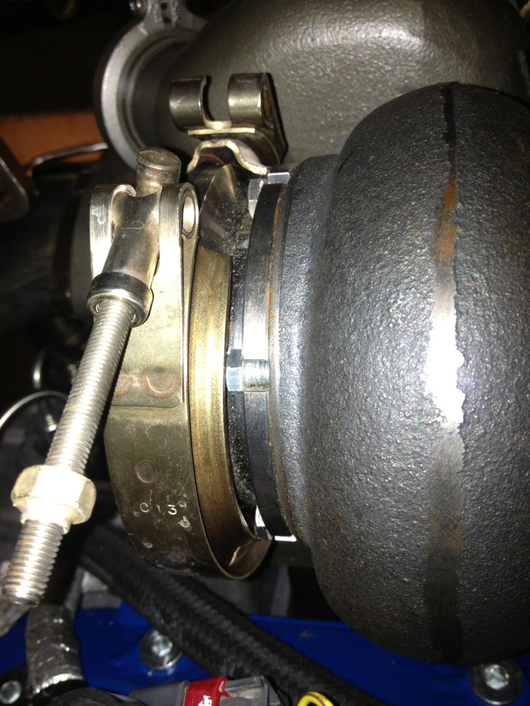

Am I doing something wrong?
Or do I need a different clamp other than the stock one for these tow x turbos?
Here's the flange coming off the 76 ImageUploadedByTapatalk1366334827.579710.jpg

I see. My solution to keep things moving ahead would be to unbolt that piece and shave the bolt heads down a bit with a grinder. Maybe those bolt heads are slightly taller than what's normally used, I honestly couldn't tell you that answer. So its either grind the heads down a touch or get in touch with elite for a solution.

I could also grind the very outer edge of the clamp down. Maybe 1/8" so it'll clear. I'll decide in the morning

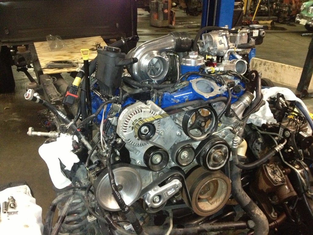

right on. that was my first thought. I'll let you know if it works out. only waiting on a few fuel fittings i had overnighted to me and getting the wastegate mounted. making the fuel lines to the second pump. and that should be about it really. wiring up the airdog which i can do once the cab is down. still planning on getting it running tomorrow...late haha

Nice build man, I am really curious how much power those turbos will make. Its gonna be a blast on the street I bet.

^^^whs. I'm curious because I want to build the exact setup. Your 30% nozzles are similar to 85 HP correct?
