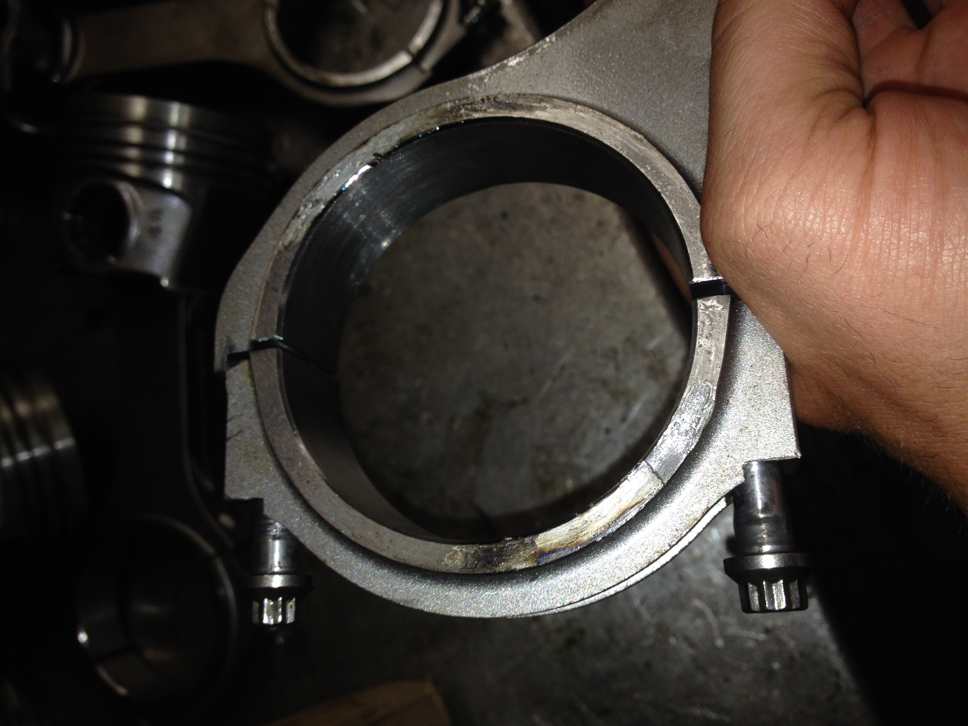

MPD used R&R rods in my build and it locked up when they starting to bring up the RPM. Engine had to be pulled and replace 2 rods that were too close...
stacked6.7
Jan 21, 2013
305
No too close to each other on the crank. Once they start to get warm and the metal expanded they stuck together and seized the motor.
It's not the rod's fault if the builder doesn't check rod side clearance. I'd be willing to bet they didn't check bearing clearances either. A true motor builder checks those things, and many many more. A parts changer simply bolts everything together and hopes it lasts long enough to get paid.
Well you just called out over half of the diesel performance repair shops and industry! LOL. Slam and go.
