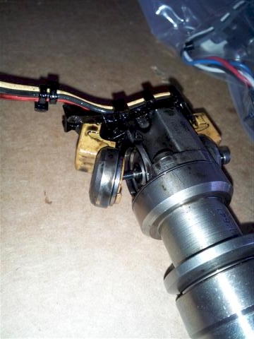

I was finally getting around to completing my pressure testing and wouldn't you know it, I suddenly developed a dead cylinder. I'm like, "WTF? Is this really happening?" A quick DTC check showed #5 cylinder fault, so that gave me a good starting point.
I figured since I had the new injectors from Full Force sitting on the tool box, now would be as good a time as any to install the injectors. So, armed with lots of caffeine, I got the top end torn off and proceeded to swap out the injectors.
Here's what I found...
(click on image to enlarge)
Any guesses as to why #5 was dead? LOL Of course, this means that my plans for pre-testing ICP & FRP with the stock injectors are now scuttled. :( Fortunately, these injectors are stock nozzles so there should still be some useful data we can obtain between the ICP tests and FRP tests, but I was really hoping to see what kind of valid power gains we'd see with simple modifications to the fuel and HPO systems. All we're really left with now is validation testing for the HPODS, which will still be extremely useful.

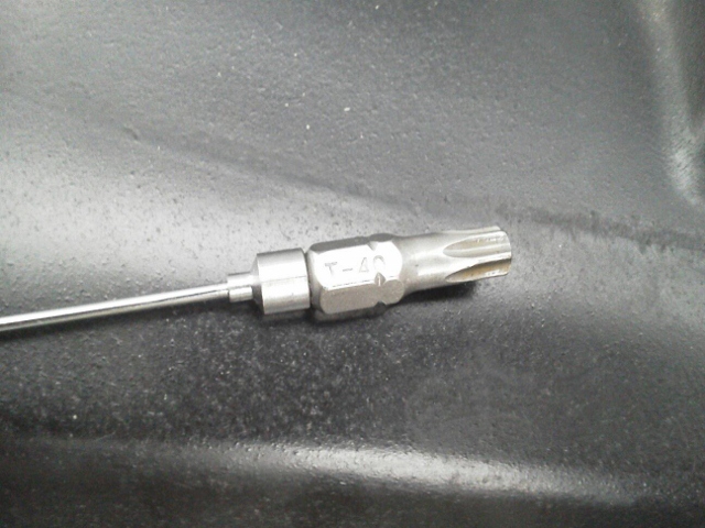

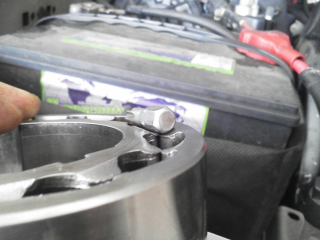

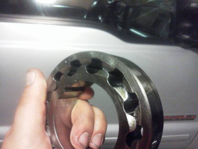

It's funny you say this a buddy of mine was working on his truck doing injectors 6 years ago and finally 6 years later his lost torx bit got suck up into the oil pump and sent metal throught LPOS. here are some pics.
