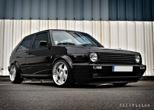

My buddy was running a 44mm on his vw mark iii pushing 400+ at the wheels running upwards of 40psi. We were gonna put a 50 on my 4.6 TT build before I jumped to a diesel.
40 psi and 400hp... in a VR6? a VR6 will make 400 hp with less than 40psi.
I never said a vr6. It was a mark 2 now that I'm thinkin better. I always get confused on those old vw's. The 2.0L 16v 4banger was pushin 400+ on 40psi.
