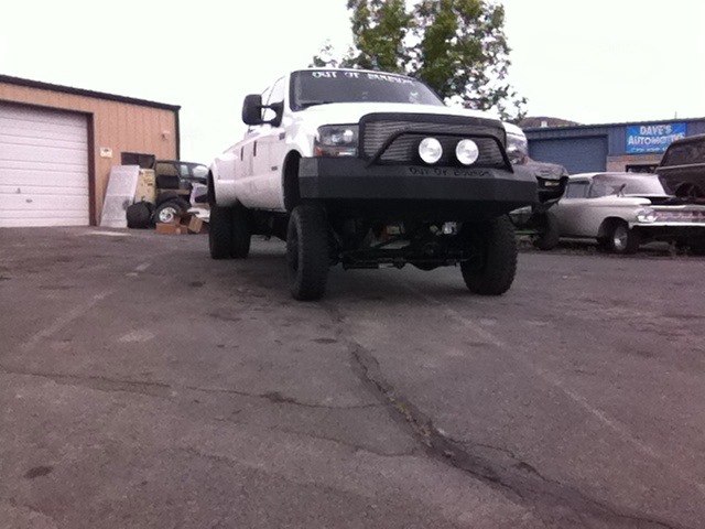

Post a pic. Its awesome with clown tires lol
Please keep the laughter to a minimum........but here goes

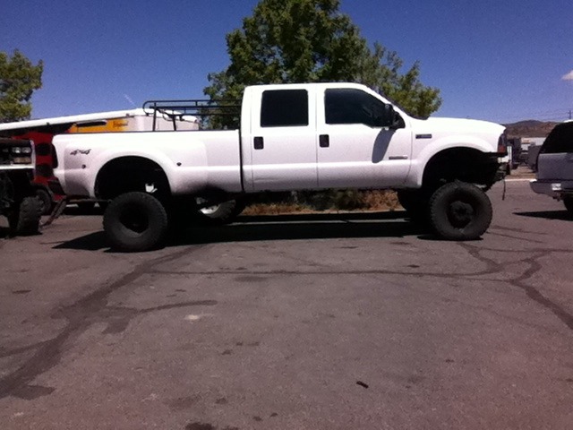

Nice truck. What tires did you order?
Haven't ordered tires yet, swapped springs with a guy with a SRW, he wanted to go stock. I am waiting on funds to get some tires, but when I do get it together I'm gonna get some 37x13.5x16 SS M16's. I would have waited to get it all together but, the situation fell in my lap, I got a 10" all spring lift for nothing more than labor. I have a bunch of stuff going to powdercoat this weekend so at least I have time to make stuff look good while I hunt for tires

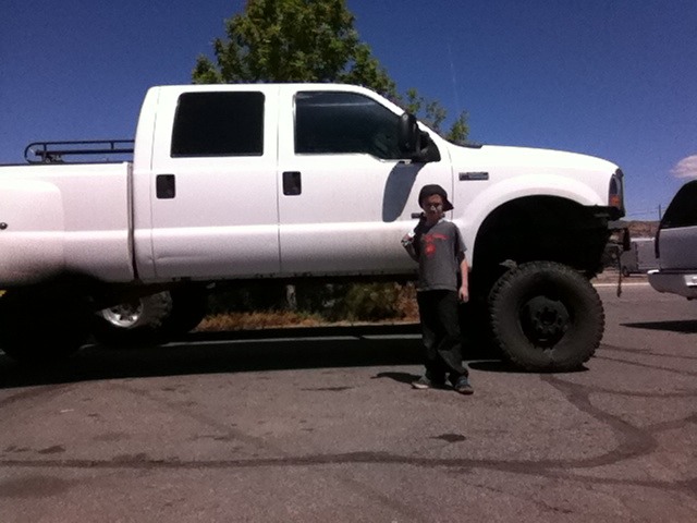

Thanks, I could fit a 40" but finding them in a 16" rim and narrow enough for a dually (13.5 is wide as hell) limits me to boggers and those won't hold up to driving on the street worth a crap. For giggles here is one of my 4' tall son next to it
Good thing I have a rocket to ride during the summer so I can get back and forth to work, but I miss my truck

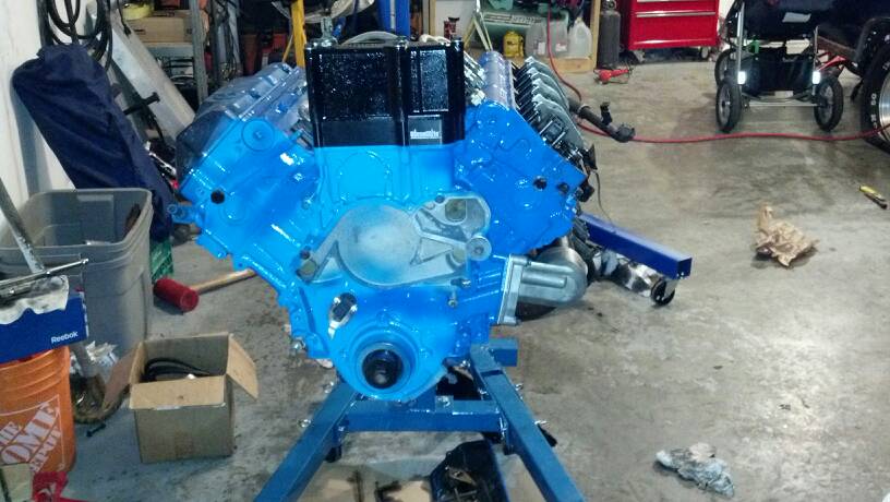

Swapped Stealth HPOP, home made 4 line output kit, H11's DI pushrods and 910's from old motor onto new one. Sent manifolds and turbo piping off to be ceramic coated. Installed new reservoir spacer too.
