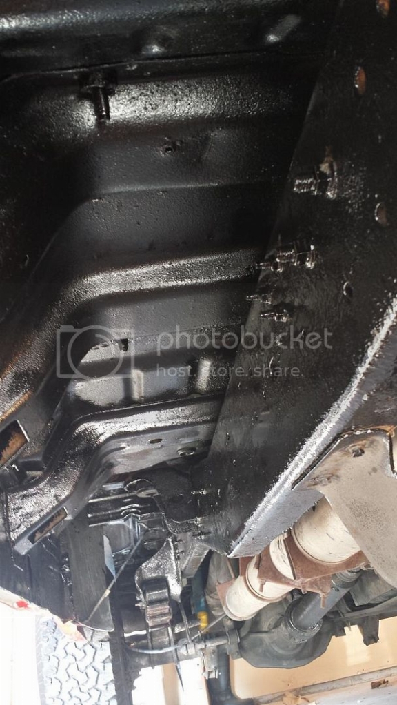

Did you paint right over the rust?
POR-15 stands for Paint Over Rust, uh, 15 I guess. I wire wheeled everything I could, then used their rust prep, then painted with a roller and a brush. The underside of the cab/bed wasn't bad (no rust build up, pretty clean actually), the frame had normal scale rust.
A lot of people using por-15 have had bad results because they cleaned the surface too much. It really does a good job at biting onto rust.
