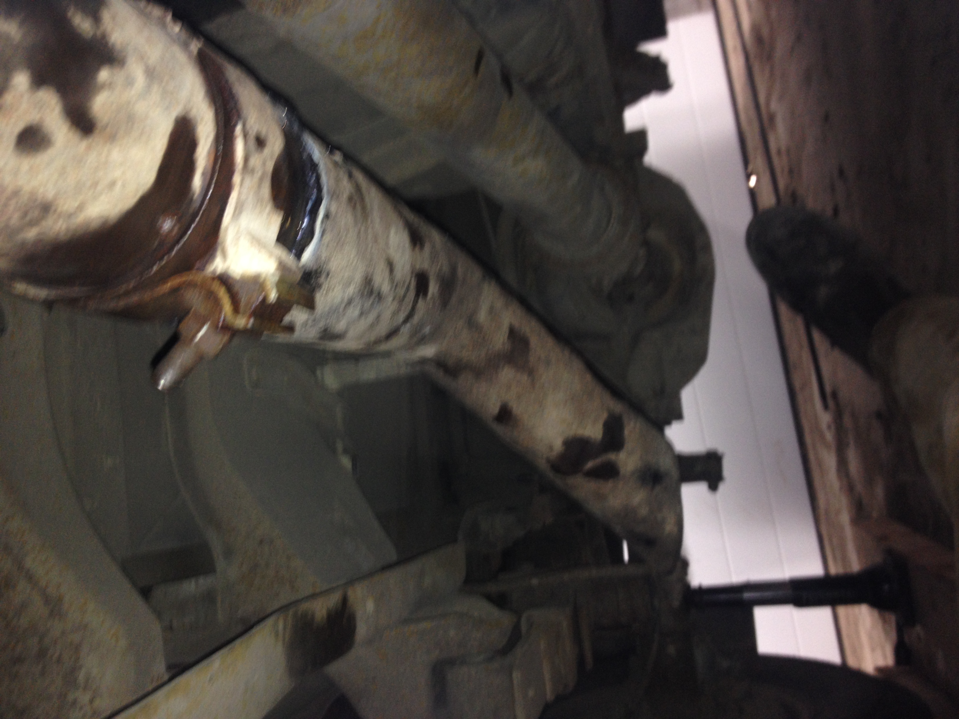

Put straight pipes on the 7.3 using the stock 3.5 inch dumping it in front of the rear tires. Welded it up using an arc welder with 6018 rod at 60 amps and I do not think I will ever use an arc welder to do exhaust work again, not a huge fan of swiss cheese.

you do realize that the factory exhaust is stainless steel and 6018 is not ment to be welded like that.. it's a all position rod but anything vertical is suposed to be ran uphill.. no dragging down... and not ment for stainless!

But still, you have to admit welding exhaust tubing with a buzz box isn't much fun LOL

Everything is making so much sense now. The fact that I was able to end up doing it though impresses myself a little bit. Guess I'll go borrow a buddies mig next time though.

dont matter to me... 1/16" 6011 is smooth on galvanized tubing..

you might want to go over it with a mig a if you have one available to borrow anyway.. it won't take long and the little bit of weld that is holding it will easily break off..

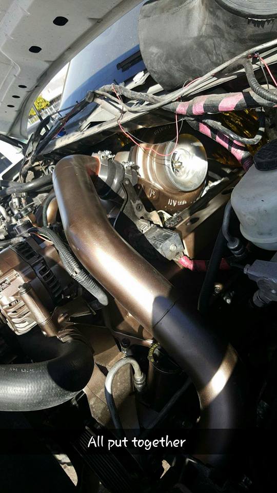

got knocked off a day and helping @Jomax get a friend of his back on the road with some parts that we had chop shop at my house LOL. Just gotta mount up fuel and crank it over :)
