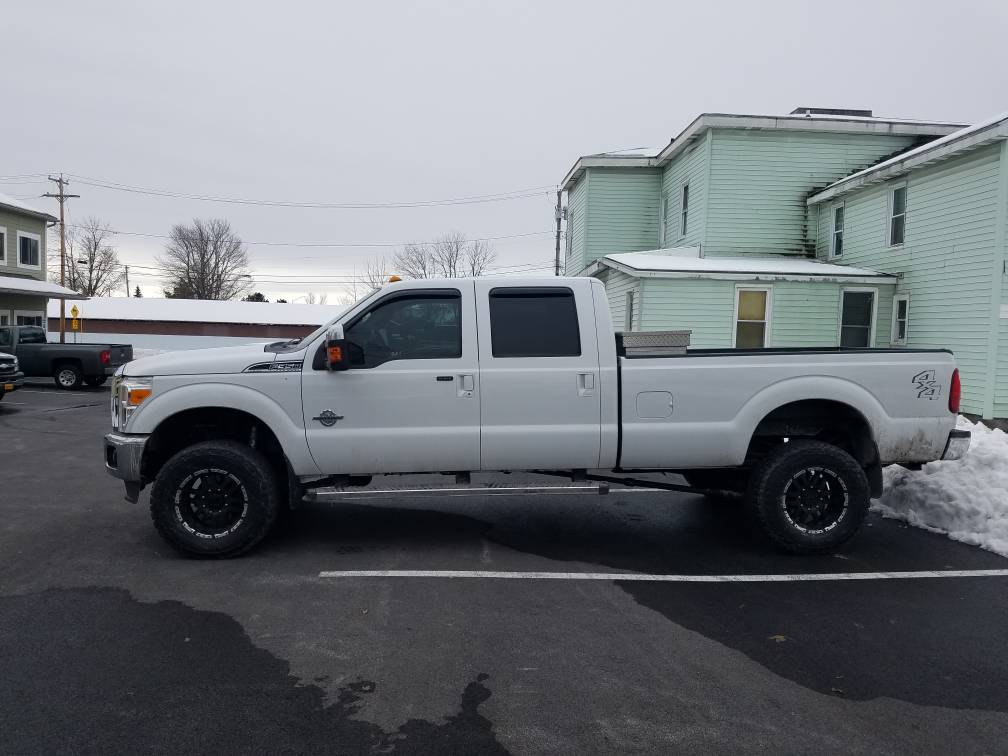

Finsished up the lift kit i pieced together. Basically supposed to be 3 inches all around. Sagging stock springs so i went with a add a leaf and a 1" block in the rear and 2.5 inch coils with a 1 inch spacer up front. Drop brackets for the trac bar and sway bar. Extensions for the shocks. New longer 3/4 u bolts. I might take the sway bar drop bracket off the front though.. it is only a 1/4" front hitting the coil base at the link end. That should pull it back a bit..
live life full throttle
Please don’t add a spacer under the coil lol. That lift already sounds pieced together. Loose the add a leaf in the back. Slope or no slope that ass end is too high.
Those rims are ugly too.
Also, I already remembered that anything higher then 2.5in of front lift, required radius arm drop brackets.

I don't know about the lift but calling his wheels ugly is a little harsh. Everyone has there own taste so to each their own, that's why there is such a large selection of wheels (among other upgradable parts)

Jake bought those rims from jomax. That’s why jomax is giving him a hard time.

Well that rim is junk so ill have to find new ones....
