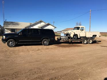

It runs well. LOL
I don’t tow with it very often, but it can.
Towed this back from Albuquerque NM just before New Year 2019. Never took it off the Hot tune. Gross was 17,500 lbs.
