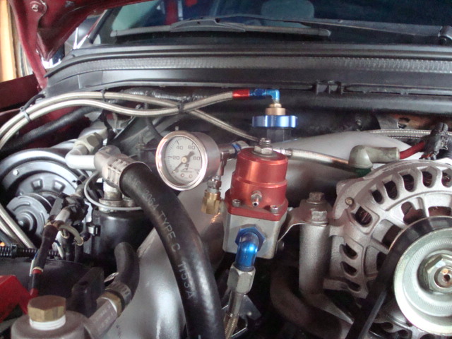

Sounds like something to look into. I don't forsee any problems. The stock regulator won't Hurt being hooked up, it has an 80 psi spring and is going to be flowing, the aeromotive will be regulated at 65-70 and have 10 psi returning to the tank- let me ask you, whats wrong with returning fuel...?it's just coming back where it came from..that's the beauty of the aeromotive pump.. To hold back pressure
i only have the aeromotive returning with pressure staying at 60psi without dropping at all. But then again, i don't have the factory fuel filter regulator/housing Just see zero need for two regulators returning...doesn't really make sense. Also, Like i said...will save on cost.

Donzimama
In the Brig (Banned)
216
I think I will block it off on both. The aeromotive is already returning you're right.

I agree with Chris (Strokin6L) no need for two regulators, I cut my stock fuel filter/regulator off of the oil filter housing and made a bracket that mounted the new areomotive regulator in its place. Works like a charm.
