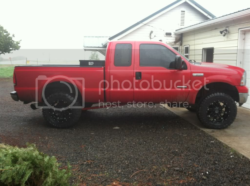

I did 2.5" day star and f350 rear blocks I'm clearing 35s 20x10 -24mm
smokedout250
2,654
harrisburg oregon
Inner fender rubbed hard but it's close. I'm been off road and all sorts of stuff after pulling the inner fender back no problems what so ever
