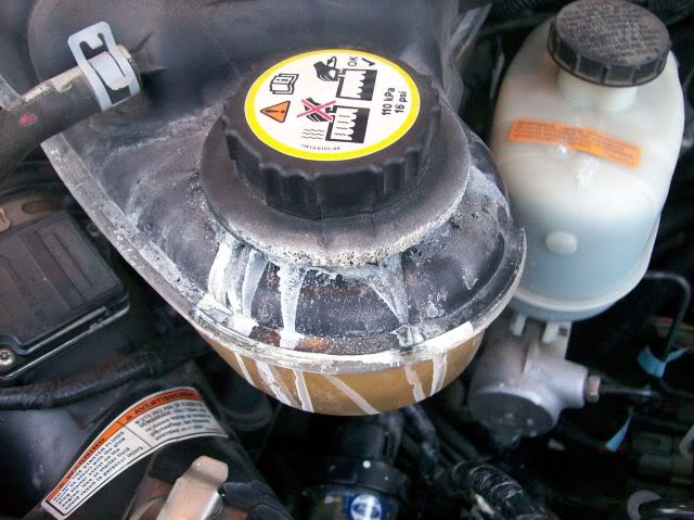

16 is where the cap pukes

16 psi is the magic number if you have blown head gaskets or EGR cooler.
16 is not the normal operating pressure.
ok. answer this then. the cooling system(any cooling system) when it heats up. expansion takes place,and so does pressure? does it not? ok that same system will keep building pressure,unless its regulated. if the cap pressure regulator is set for 16 psi. then tell me how the system is only going to operate at 5-7? if the cap didnt have a regulator relief,the system would build pressure until it pushed coolant past seals and hoses. thermal expansion,heat,and pressure. when head gaskets leak,combustion gases enter the cooling system,raisng the pressure rapidly beyond what the cap regulator can handle,thus throwing the system severly over the 16 psi normal operating range. as the gases make there way to the bottle,the boiling/over pressure has no where to go but take the path of least resistance. the cap. puke!!!!
If the cap pukes at 16, the normal opertaing can not be 16. If the was the case the cap would be puking the whole time the truck is running. If that cap pukes at 16, then the normal opertating pressure needs to be less that.
This cant be correct. I know you. You know what your talking about. But i must call this into question
ok 16 psi isnt a puke point. headgasket or other typical failure is puke point.
the system is going to run within 1-2 psi under 16psi. that is where the cap will begin to bleed pressure to maintain a cooling system pressure of 16 psi max. if the cap started bleeding pressure at 16psi,obviously the system would go over 16. anyone that has a cooling system pressure tester,do this. take the cap off your bottle on any vehicle of your choice,put the pressure tester equipped with a gauge on. take the vehcile for a ride. you will see the cooling system pressure rize up beyond what the cap psi is. this is because you removed the regulating cap from the system,the pressure tester cap now has the cooling system capped. no regulator. if artic or anyone that disagrees with me thinks that the system is just going to run at 5-7 psi by itself,with no regulator will see for themselves that the needle on the gauge will rize,and the system will build pressure til a hose or seal lets loose.
heat,and coolant circulation makes pressure!!!!
