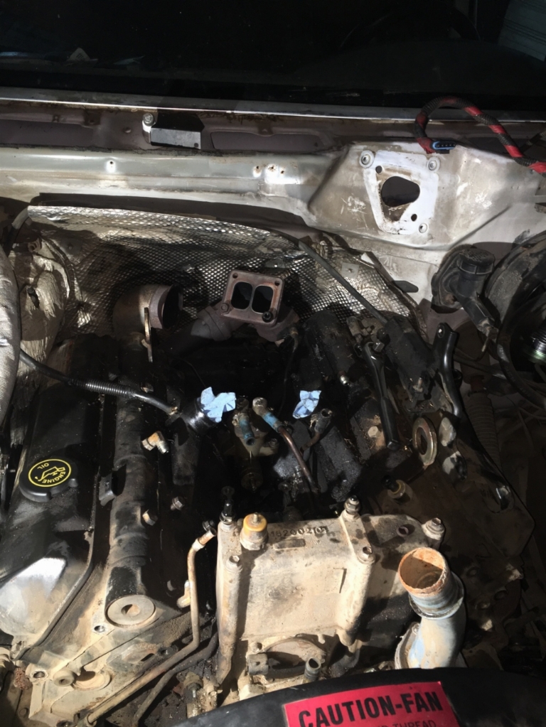

Tittle pretty much says it all. I have a 1994 f250 7.3. I blew a head gasket so while I have everything apart I was wondering what I need to replace or upgrade while I have everything ripped apart. Any advice is appreciated.

The big things would be the glow plugs and high pressure oil rail plugs on the ends of the heads all 4 of them. Some would say the injector cups but I believe that if they are not giving you any problems to leave them alone.
