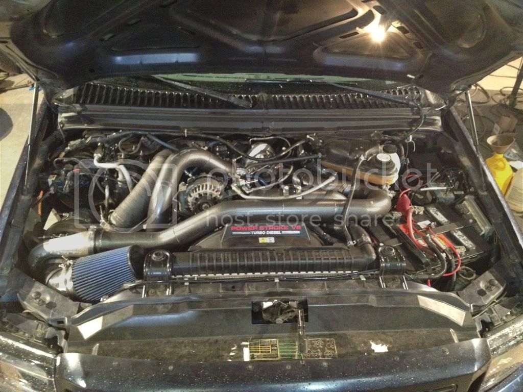

Here is a pic all finished up.

Explain the air flow to me on this.
Large turbo, feeding small turbo air, then small turbo feeding large turbo exhaust?
Extended Power
May 24, 2011
2,216
Wouldn't that be harsh on the small turbo supporting all the boost from the larger one?
Sorry for the questions. Just looking into the compound set ups.
Nope...it's a compressor...it doesn't care what the pressure of the air is as it enters the compressor inlet...it's still gonna compress it sumore.
Normal air pressure is 14.7 psi @ sea level...throwing another 30-40 psi on top of that is ok.
