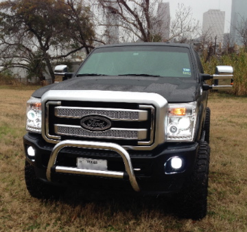

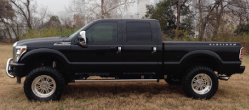

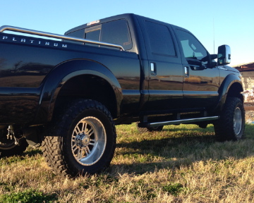

Here's my previous setup with 6 inch lift, 37x13.5x20 tires, and 20x10 wheels...

You won't be able to fit more than -24 offset on 6 inches of lift without substantial rub.
