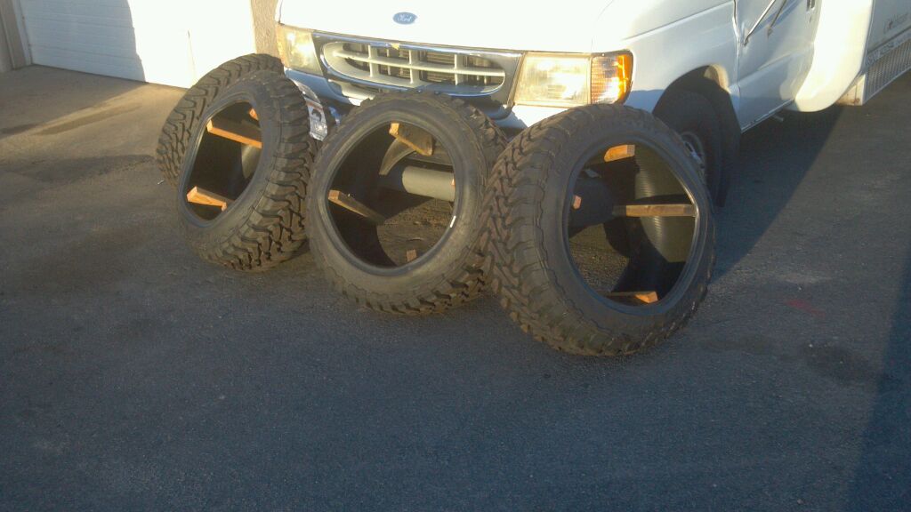

thanks man, I'm thinking I can pull it off. I've already trimmed a little off my fender for extra clearance just in case when I installed the 37's. It doesnt come close to it. Any tips on mounting the tires? You have any more pics of the black cclb?
I don't on my phone but I will see what I can find. As far as mounting 2 cheetah.tanks and a air hose on one of the valve stems. Also helps if the tires are warm like in the sun or.in front of heater. Or like we did Buddys helps. Stretch em with 14 inch 2x4s for a while.
