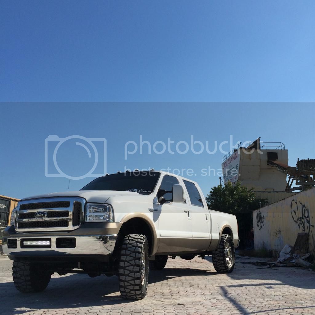

My 6.0. F350 4x4 with rear block removed, stock front, 2" wheel centric wheel spacers, lariat stock 18s, 275/70/18. No rubbing beautiful stance. (Had to shave the nipple off the wheel studs on the front, they were a hair to long and wouldn't let the stock rims sit flush, to run stock rims GET WHEEL CENTRIC SPACERS, or you will have a rough ride)

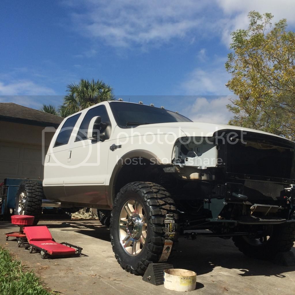

In the middle of doing an overhaul on the truck, here's the stance now.

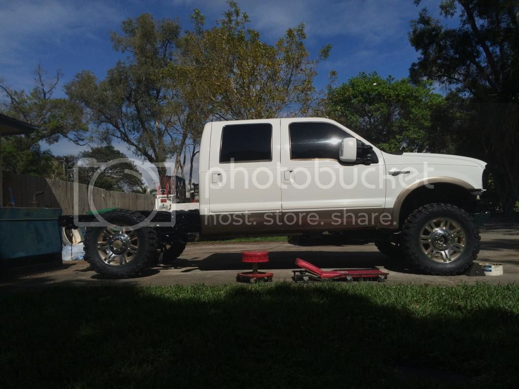

F350 4x4, no rear block, 2.5" leveling kit donuts on front coils, 2014 stock king ranch 20s wrapped in new 35x12.50/20 mud grapplers, on 2" wheel centric wheel spacers, no rubbing so far, haven't drivin it yet though.
Loving the more agressive stance so far

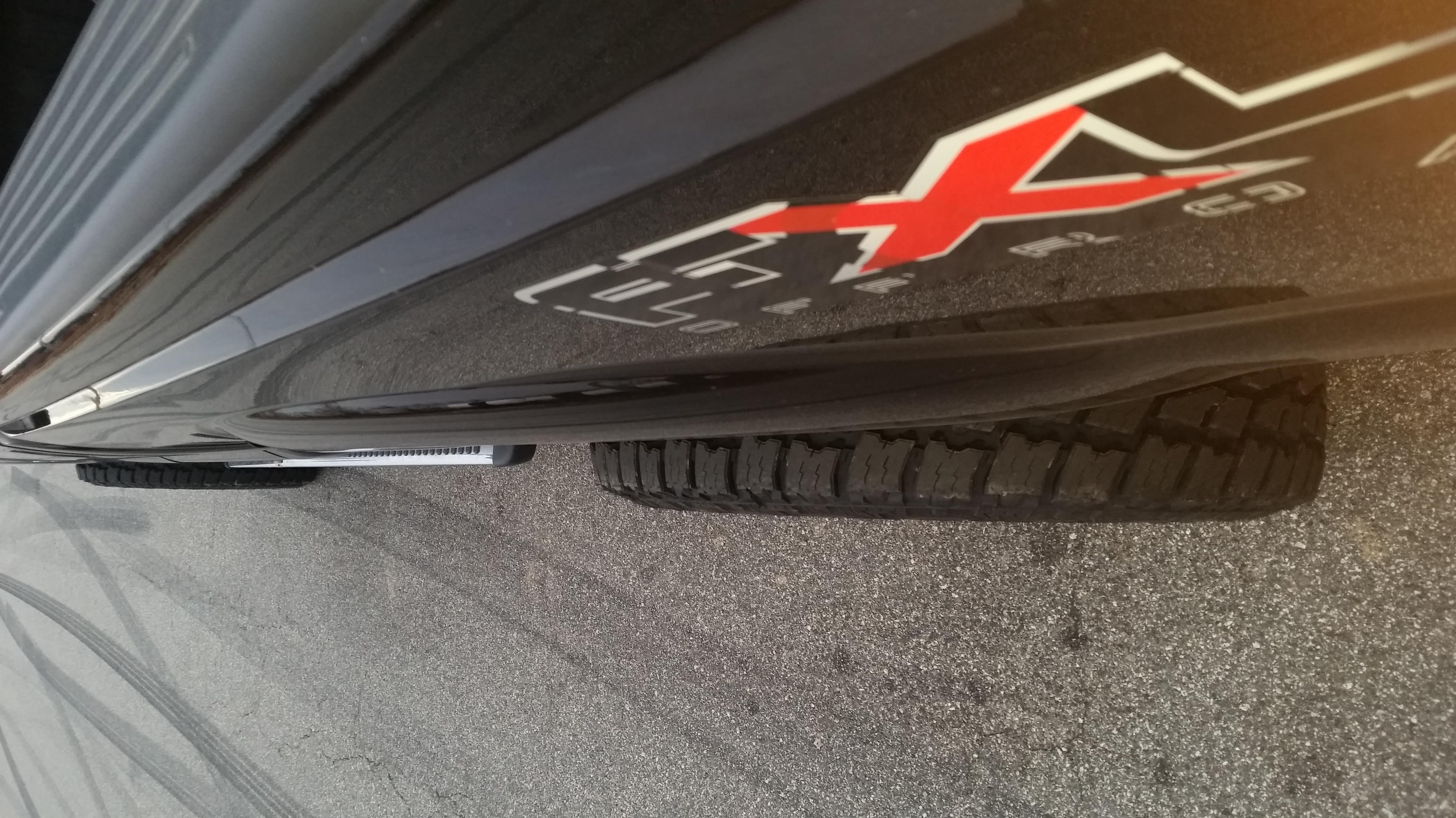

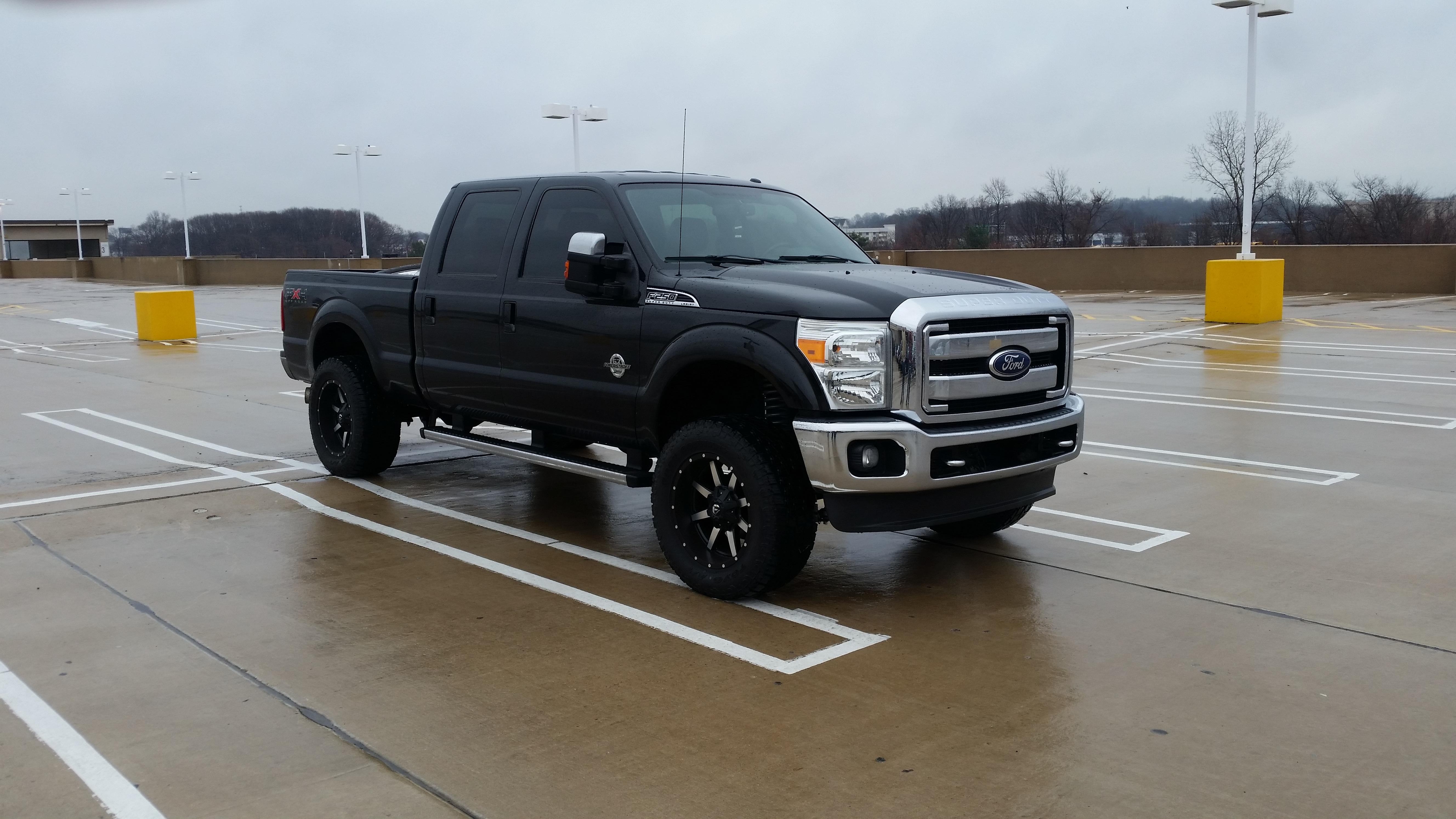

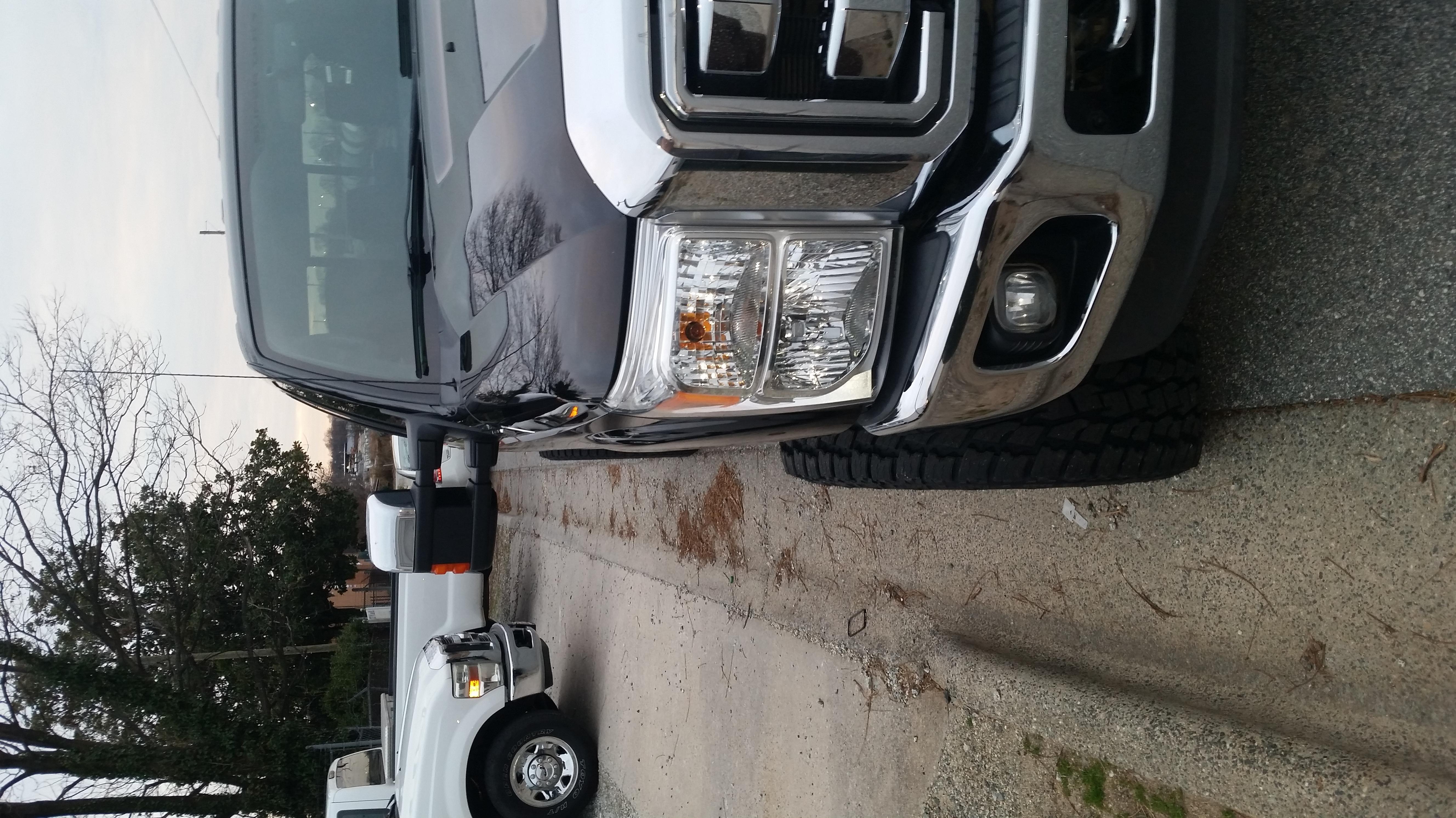

I just bought some fuel nutz 20x10 -24 offset with Nitto Trail grappler Mt. I have 2011 f250 they are going on stock height. I am considering 2.5" level kit or 4" lift. If I decide to go with 2.5 level kit will the tires rub? How much will stick out? Thinking of some bushwhacker flares to hopefully cover them up.
Here is my truck now and the new wheels I just picked up to go on it this weekend.

Put them on. Had to modify the front lower bumper basket on both sides. Also had to trim inside the fender (the felt) on both sides. No scrubbing now. Completely stock height. Wheels 20x10 -24 offset 35x12.50 Nitto grappler MT's. Looks really good in person. Adding flares and 2" level kit next week...
